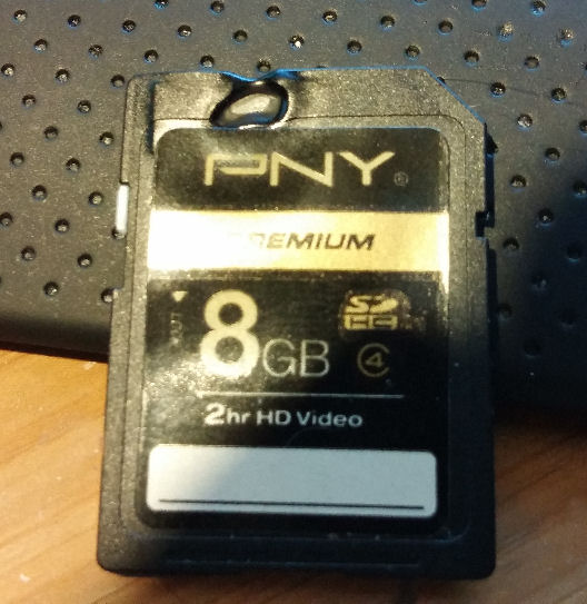

Look at the reader, pull the SD card... and there is what I can only call a MELTED HOLE IN THE END OF THE SD CARD (see attached picture)
the SD card is unreadable. (used another Mobilelite to test with)

Looking at the picture, I am shocked at what I saw.  USB ports are suppose to have only 5 volts on them with a limit on the current--900ma MAX.  I find it hard to believe that much damage could be done by 4.5 watts.  Since you indicated that you could get to the BIOS, the PS is apparently working.  I would be most suspicious of that USB port.  I would use another header for any further testing.  (There should a minimum of two USB headers in almost all modern MB.)
You might try formatting another memory stick and install unRAID on it as see if the server will boot from that stick.  If it does, you might try your other Mobilelite with a new SD card.  If that boots, E-mail LineTech, give them the GUID of the new Mobilite, describe what happened and request a new registration linked to that Mobilite.  They have been good at supplying replacement files.

that old frame the server was on is not in the picture any more, I'm working with the new one now... but that sounds reasonable (blown port)
