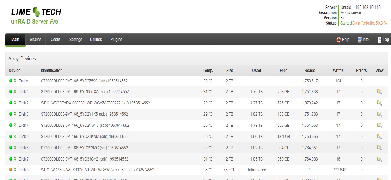

When I start unraid it shows orange ball and attempts to rebuild only to come back unformatted.
Is there a way to rebuild the drive from parity? Is that even an option?
I'm in trouble, can someone help. What can  I include to help diagnose this issue?

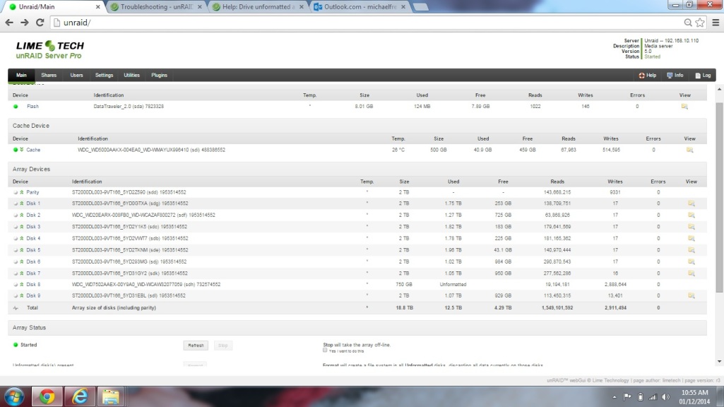

How do I find the actual version of unraid i'm using. The main page says 5.0?

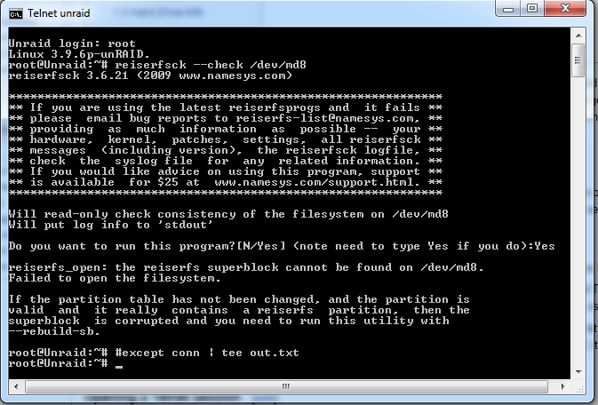

Note, however, that unformatted status in unRAID frequently does not mean that the disk is really unformatted - just that unRAID could not mount it.  This is typically due to a failed write that left behinf some sort of file system level corruption.  The normal recovery process is
  • Stop the array and then restart in Maintenance mode
  • From a console/telnet session run a command of the form
    reiserfsck --check /dev/md?
    where ? corresponds to the disk number in the unraid GUI
  • The command above will access the disk in read-only mode and check for corruption and suggest a recommended way forward.  Typically this means rerunning the reiserfsck command with a something other than --check as the option.  It is a good idea to check back here giving the output from the --check run to see if others think the recommended action makes sense as taking inappropriate action can lead to definite data loss
In terms of the unRAID version number it is the value displayed at the top right of the standard GUI.  The current v5 latest release is 5.0.6.
Here is the output from reiserfsck --check /dev/md8
I there a better way to output from telnet than a print screen?

See check disk file systems in my sig. Run with --rebuild-sb.
I did and retrieved some of my pictures. There were a lot of files with no extensions that I couldn't figure out.
