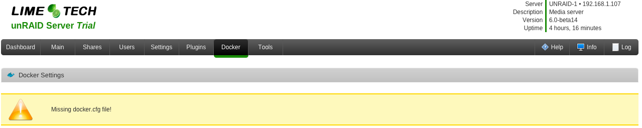

I'm new to unRAID.  I've installed unRAID 6.0 Beta 14 today.  I'm trying to use Docker and it tells me I'm missing the docker.cfg file, see attached.
I can't find anything that tells me why.

Hmm. This was a fresh install just today?  Never used unraid before?  Definitely odd behavior. Can you click on tools, system log, scroll to the bottom, click download, and post it here?
Yes, just downloaded 6.0 Beta 14 this morning.  I had a small trial version of unRAID 5 that I was testing with.  I copied the files from it's config directory to the new install/flash.  Maybe that broke something?

Ok, I am going to test this first thing in the morning on one of my test systems.  I'm going to move this thread to the defect report board for now so it's a reminder.
I am having the same issue. I have pro license and went from the latest version of Unraid 5 to 6 beta14. I copied the contents of my flash drive. Followed the instruction on the release notes for unraid 6 for a new install. After completing the instructions I copied my config folder over per the upgrade instructions. I was prompted to over write 5 files which I said ok to.
Was going to try and get owncloud working but immediately ran into the missing docker.cfg.
I can confirm this is a bug.  Was able to recreate this morning.  Guess this one slipped by testing.  Will get it resolved.
As a temporary workaround, you can login via ssh or telnet and type this command:
/etc/rc.d/rc.docker start
You should get a response of:
Not starting Docker: no image file defined
That is fine.  The command will have succeeded in created a docker.cfg file within /boot/config.  Exit your terminal session and go back to the webGui and click on the Docker tab.  You can now specify an image file and start the service.
We will be fixing this ASAP as it's a pretty big issue.  Thank you for reporting.
Thanks for the update.
The workaround did work for me.
