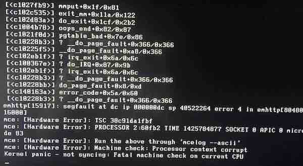

Well definitely not a network issue and not what I was expecting to see. Seems as though my CPU is flaking. Am I reading that correctly?
I tried the tail command but it wouldn't output any good info. I hooked a monitor up to it, and this is what I got.
I would suggest a few actions:
- Check all the fans are working and clear any dust out the system in case there is an over-heating issue.
- rub a Memtest from the unRAID boot menu to check a RAMA stick is not going bad.
