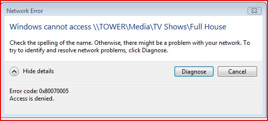

I've been getting the following error on 3-4 subdirectories ONLY, which appears to have just started recently for some unknown reason.
"You do not have permission to access the file "\\tower\media\TV Shows\Full House" (see attached.)
I've gone in to check / reset the permissions on those folders but I'm unable to make any changes.
All of the typical changes to allow permission are not working.
Access to all of the remaining sub folders have not been impacted.
Any help would be appreciated.
Thanks

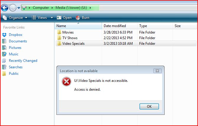

Never did resolve the issue of accessing select sub-directories.
I had left this alone for a while but now need to access the files stored in the sub-directories on these shares.
Have tried the ideas suggested in the replies to this topic but I can't get this to work.
I've since purchased a few new laptops, etc. so i don't think there is a correlation to the credentials on the devices as I just mapped one of the devices today and the access is identical to the other PC's.
We have some essential family docs that I need to access in addition to movies, etc..
I know the files are still there because I can see them when I search the shares in unRAID.
There are only a few sub-directories that aren't acceptable. All of the network drives are accessible, it is just a few sub directories within the drives that are restricted.
Any help is appreciated.
Thanks

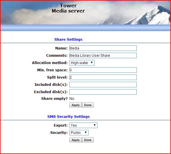

Are these public shares? How are the files in these shares being created?
All shares are public.
The files created in one of the sub-directories impacted are video files that were created on the primary PC that I used to manage the unRAID server. If I'm not mistaken, I created the shares under the share, add share screen in unRAID.

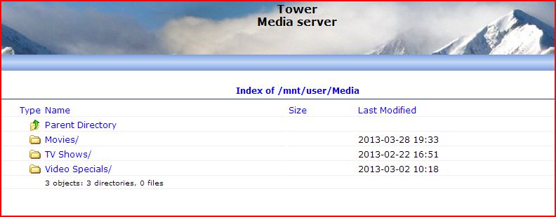

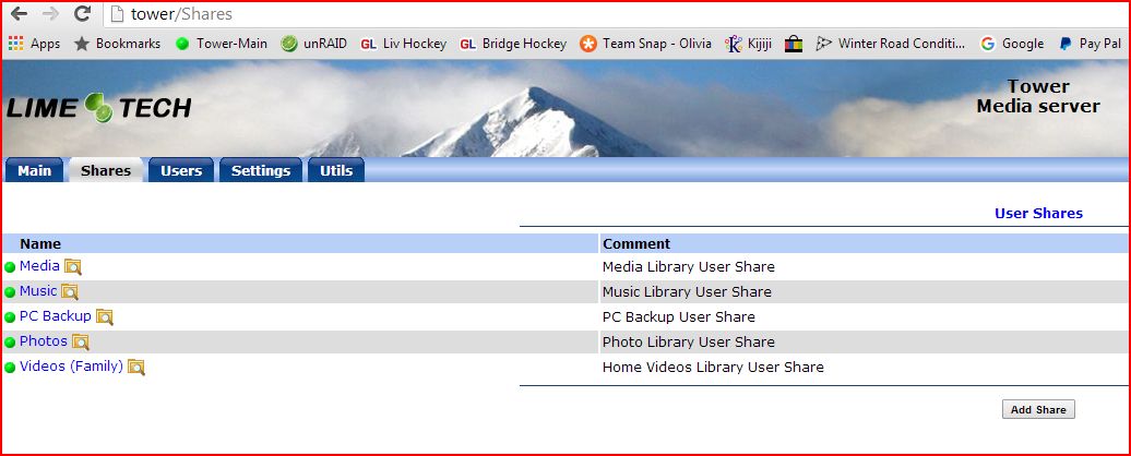

I've included a few screen shots of what I'm up against.
Appreciate your help
Additional screen captures

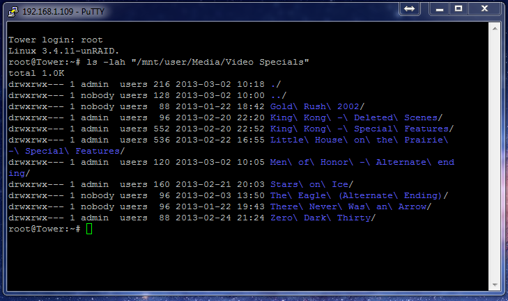

From unRAID command line, post the results of
ls -lah "/mnt/user/Media/Video Specials"
Here it is...

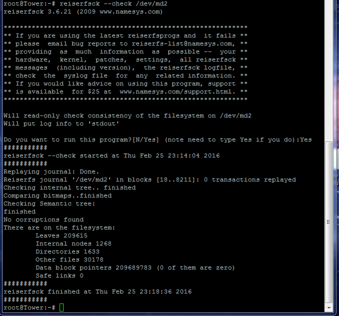

Permissions/owners look OK. Even though I didn't see anything in syslog you might try figuring out which disk one of these files is on and checking its filesystem.
Thanks for your help.
I believe at least some of the files are on disk 2.
Without sounding too ignorant, how do I check the file system for that disk?
Got it.
Will research the Wiki.

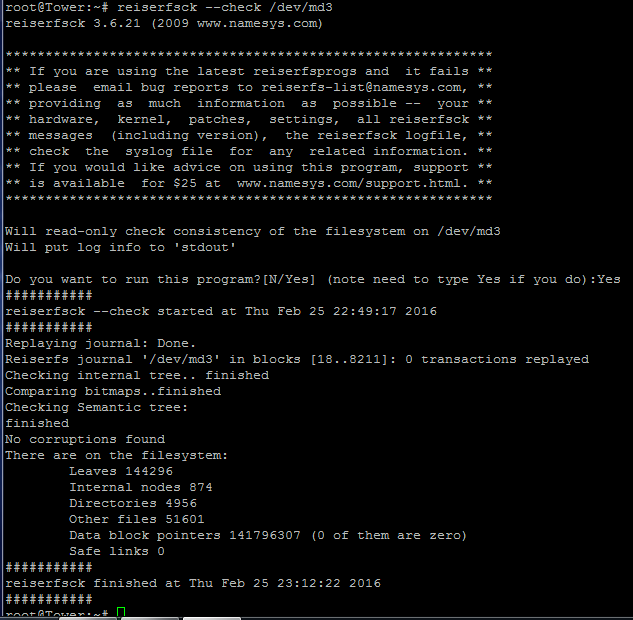

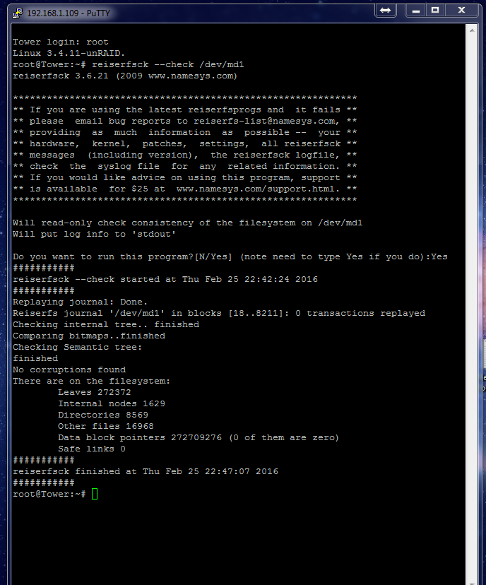

That wiki link is directly to the article about checking filesystems.
You should do the filesystem checks before trying to move anything.
Google "Midnight Commander" for an easy to use file manager you can use directly on your server. It's already included.
Ran the check on the file system for each of the 3 data disks. I've attached the results.
From what I can tell, no issues found.
I'm assuming that I can't run a check on the parity disk?
Any other thoughts before I check into the Midnight Commander option?

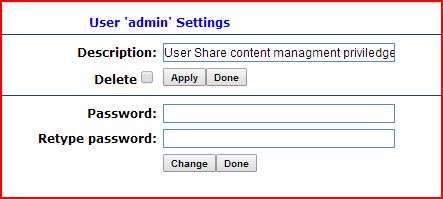

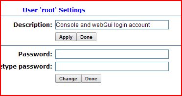

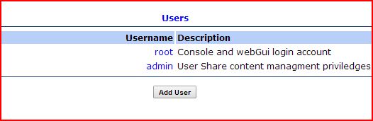

Does your unRAID have a user with the same name as your windows user?
I don't believe so...
This is what I have set up as far as I can tell.
Seems like it should work anyway since these are public shares, but you might try setting up a user and then clearing credentials.
Technically root user cannot be used for network access to shares, but that really just means that user cannot be used for access to secure or private shares since anyone has full access to public shares.
