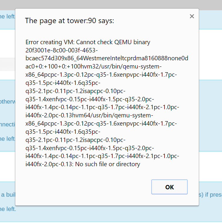

I'm running the latest Unraid 6.0b15 and attempting to setup a Windows VM through the KVM interface built into Unraid, and when I configure all of my options and hit the "create" button, I am getting this error message (see attached image).
Any ideas? Am I missing something really obvious here???
Please boot into your BIOS and make sure all virtualization settings are enabled.

I was sure it was configured, but I will hook the server up to a monitor and double check.....I'll report back if it works.

You can also try adjusting the cpu type on advanced mode from host pass through to qemu emulated.
Problem solved! For some reason my BIOS setting had been changed.
All seems to be working smoothly now.
Thanks for the quick response jonp.
