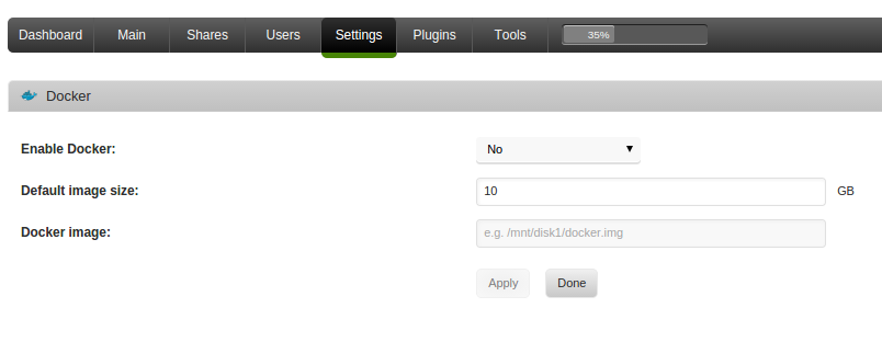

Hi, total newbie on dockers here :)
i want to try create my first docker - so went to Settings/Docker but field for Docker Image is disabled..
what i'm missing?
when i set Enable Docker/Apply then nothing happens. Log says: Not starting Docker: no image file defined
i'm on unRAID V6/b15

but how i can change this - field is disabled.. look at picture.
and yes, i have cache drive.

looks like i found a bug :) this happens with google chrome, it works ok with Internet explorer..
cos i have ubuntu workstation, no other browsers here.
tried then from Windows machine and voila.
