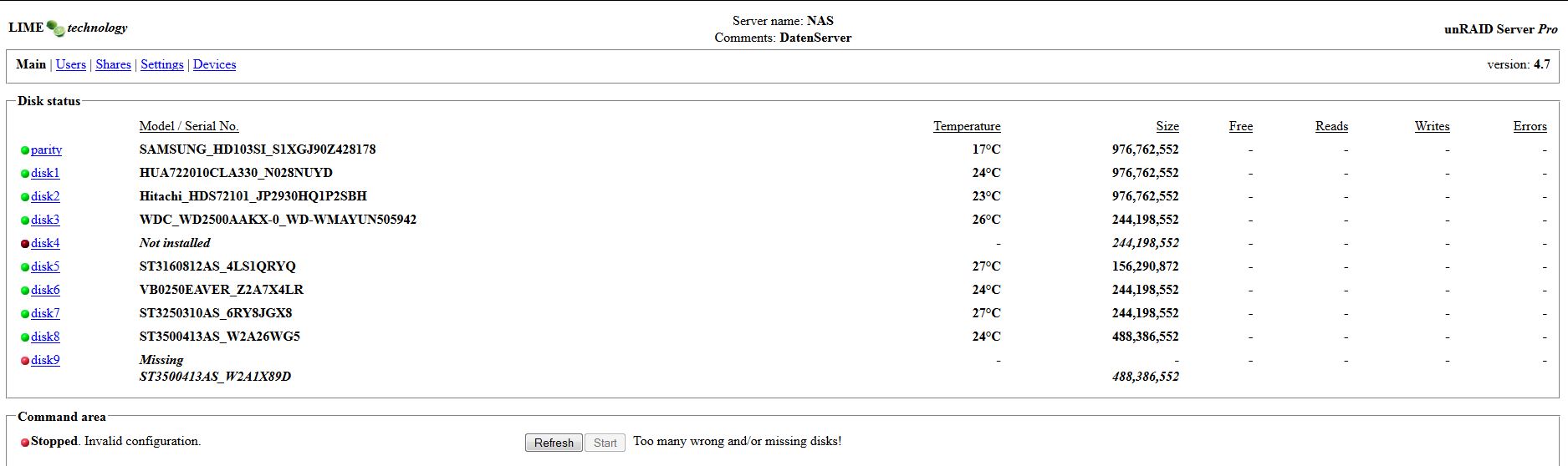

After changing the PSU one of my Drives got a Red Ball (the Drive got a Headcrash), and suddenly another Driver is missing.
In the Screenshot you can see Drive 4 and 9 got an error.
4 is the one with the Headcrash.
9 ist the one missing.

unRAID cannot recover data with two drives missing.
However if drive 9 is actually OK, and you can resolve why it is missing then recovery of drive 4 may well be feasible.  You probably need to check all the cabling to drive 9 is OK.  Also, is it being seen by your BIOS - if not it may well have failed as well.
