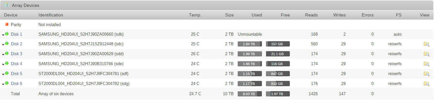

The 6th, though, is telling me under "Used" that it is unmountable. Otherwise no obvious errors are reported (green "normal operation" for the drive). What does this mean? Was this my parity drive, or did something happen to this drive? Looking through the other drives I see nothing could obviously be the parity drive, but to be perfectly honest I don't know what that would look like anyway.
Attached picture of array devices in web UI.
The parity drive will always show up as uncountable as it has no file system.
Yes, that was your parity drive.  You can Stop the array; do a New Config;  assign that drive as parity and all of the others as data drives;  and then Start the array and your system will be configured fine => it will start a parity sync, which will take a long time (probably 6-8 hours).    After the parity sync completes, run a parity check to confirm all went well (another long process).
