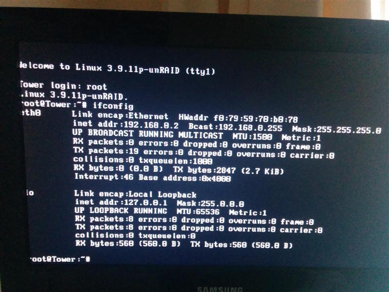

I've attached the ifconfig... Had to take a pic on my phone.
Any suggestions?

The picture shows you haven't yet changed your IP, it's still 192.168.0.2.
I only used 0.2 because I thought it'd be a recognised address on the router.
The router would recognize it alright, and know it's not yours!  You really need to change to either DHCP or 192.168.0.9, and reboot.  Setting it to use DHCP would show us what responses you get, if any.  In the picture, you transmitted 19 packets (TX=19), but not one came back (RX=0), so no one at all is talking to you.  What is the network cable connected to on the other end, a switch or a router?  The fact that the eth0 link came up means there's a working ethernet component on the other end of the cable, but so far, there is no evidence at all of a router on the network.
