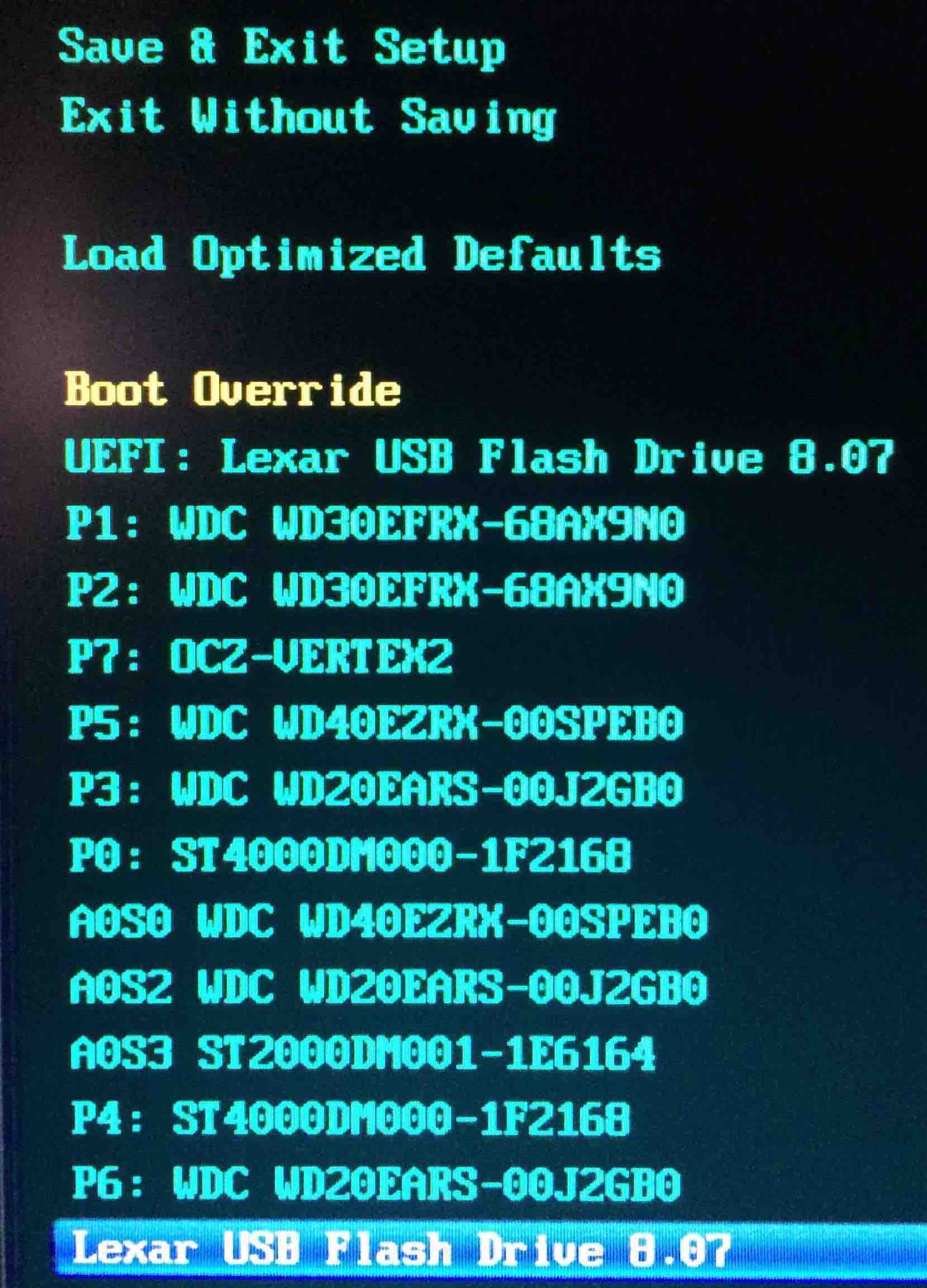

Kept poking around and made some progress.
1. the BIOS I was looking at was for the Marvell SATA card not for the Gigabyte motherboard. I had my suspicions that I was looking at the wrong thing.
Solved with a Google search telling me to press DEL key to access BIOS.
Note that 10 year old iMac keyboards don't have the required forward DEL key to access the BIOS.
Find a new keyboard, press DEL at the right time and can now access Gigabyte motherboard BIOS.
Changed BIOS setting to display power on self test (POST) which contains BIOS instructions rather than the pretty Gigabyte splash screen.
Looked through device boot settings, looked ok. But still wouldn't boot USB drive.
Found what seemed to be the exit screen for the BIOS settings which listed all the server storage devices.
At the top of the list was my Lexar USB and also at the bottom was the Lexar USB.
I chose the Lexar at the bottom of the list and rebooted.
Boots into Unraid ok.
I'll now try to boot using the other Unraid Pro 3 & 4 drives that I have so check that they work before proceeding to v6 upgrade.
Here's the BIOS screen.
Note that the Lexar device at the top is what the Boot Device menu allows me to select, but it doesn't work.
But if I choose the Lexar at the bottom of the list, it boots ok.
I have seen that before on my own system where the USB device is presented both as a UEFI device and as a non-UEFI device.  Only the non-UEFI one works.
I am not sure what you need to do on your system to get the non-UEFI one offered as an option in the Boot Device menu.  I have had similar problems on my own system in the past but by 'fumbling' around plugging/unplugging USB devices have managed to get the BIOS to recognise the non-UEFI one as a boot device I can set.  Never been quite sure what was the action that fixes the issue.
