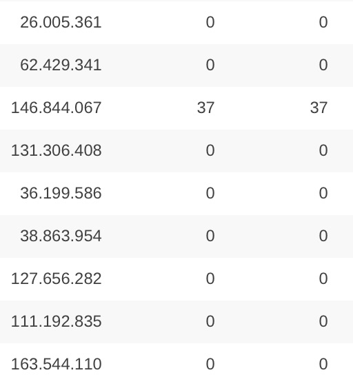

Last night I run a parity check, no sync errors but again disk errors, this time it was disk4. There is one thing I don't unterstand, a parity check is a read only process, right? So why are there 37 writes on disk 4? 37 writes, 37 error, coincidence? The other data disks shows 0 writes (see screenshot starting with disk2. First column is reads, second writes and third errors.)
The array is still accessible during parity operations. The parity check is read-only. There could be any number of other processes access the array at any time.
True but I ran the parity check at night, all systems that could access the unRAID Server were powered down. So there shouldn't be any access except unRAID itself. Anyway, so it is just coincidence that there are 37 writes and 37 errors.
Any ideas what I could do to find the reason for the random error?

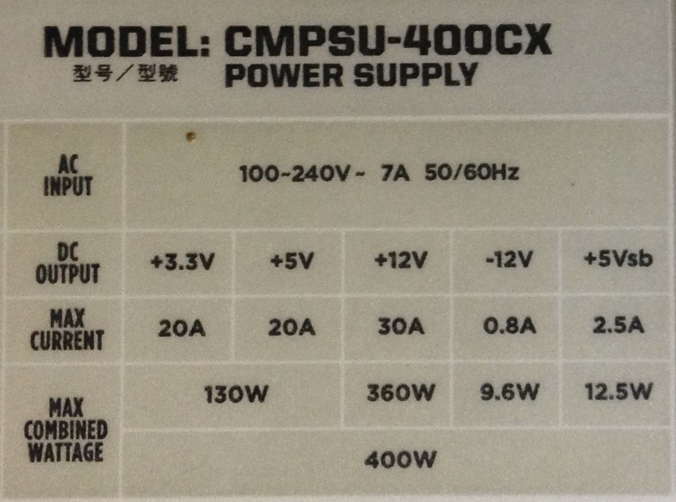

It is a 400W Corsair power supply. CMPSU-400CX
Power supply has reached its limit. Get >40-50Amp 12V rail.
Oh really? Before I bought this PSU a few years ago I checked the forum (or the wiki?) and it should support up to 12 drives.
Anyway, this could be the reason, I've added a new drive recently and I've never had any issues before. I think for a quick fix I'll remove an old 1 TB drive from the array. If I'm back to ten drives the psu should be fine again.
Thank you for your help.
