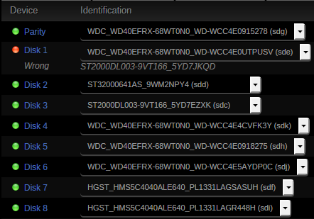

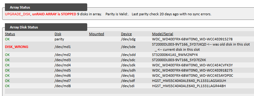

7.  powered up unRAID server.  I expected to be able to select the new data disk (as Disk 1) and get a blue ball.
Screenshots and syslog attached.  What would be the next step?

I think you missed a step?
At this point the way forward would be:
  • Stop the array and unassign the problem disk
  • Start the array again.  It should now say the disk is missing
  • Stop the array and assign the disk again.    This time you should be told that starting the array will start a rebuild onto the replacement disk
  • Start the array and the rebuild should start.  When it completes you will be back in a protected state.  You should still be able to access its contents even while the rebuild is in progress as unRAID will be emulating it from the combination of the other disks plus parity
My guess is that for some reason unRAID never realised the disk was being replaced (because you never forced the 'missing' state) which is why it is now complaining about the wrong disk.

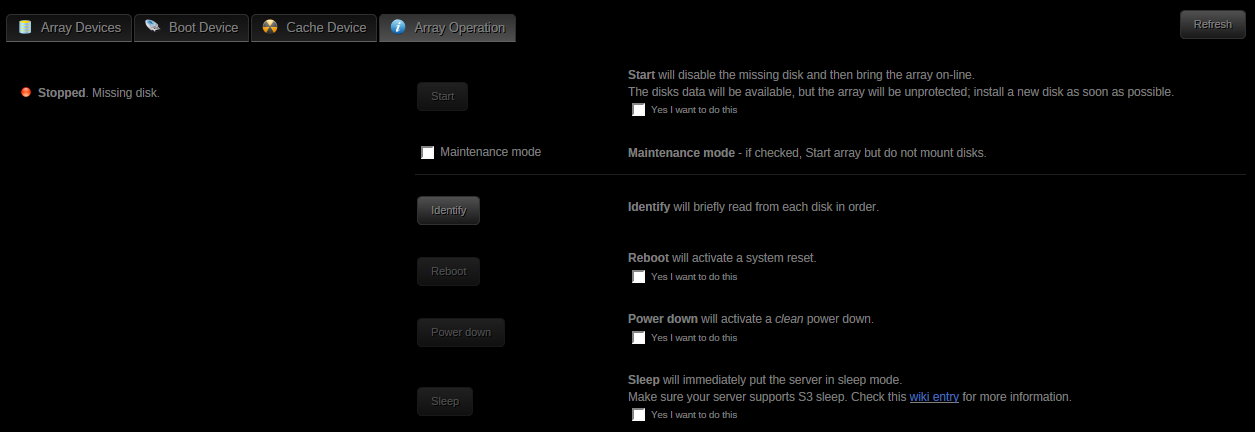

With Disk 1 (failed data disk slot) unassigned, I saw this message on the Array Status page (screenshot attached) "Start will disable the missing disk then bring the array online.  The disks data will be available, but the array will be unprotected; install a new data disk as soon as possible."

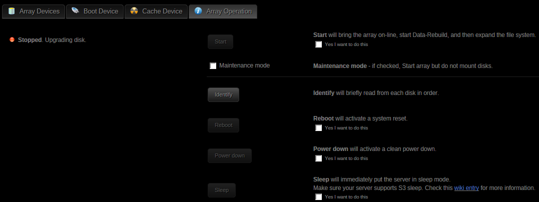

I clicked "yes I want to do this" check box and started the array.  The missing (failed) data disk was then disabled (forced the "missing" state).  I was able to then stop the array, assign the new data disk (with a blue ball) and start the array to begin the data disk rebuild process.
