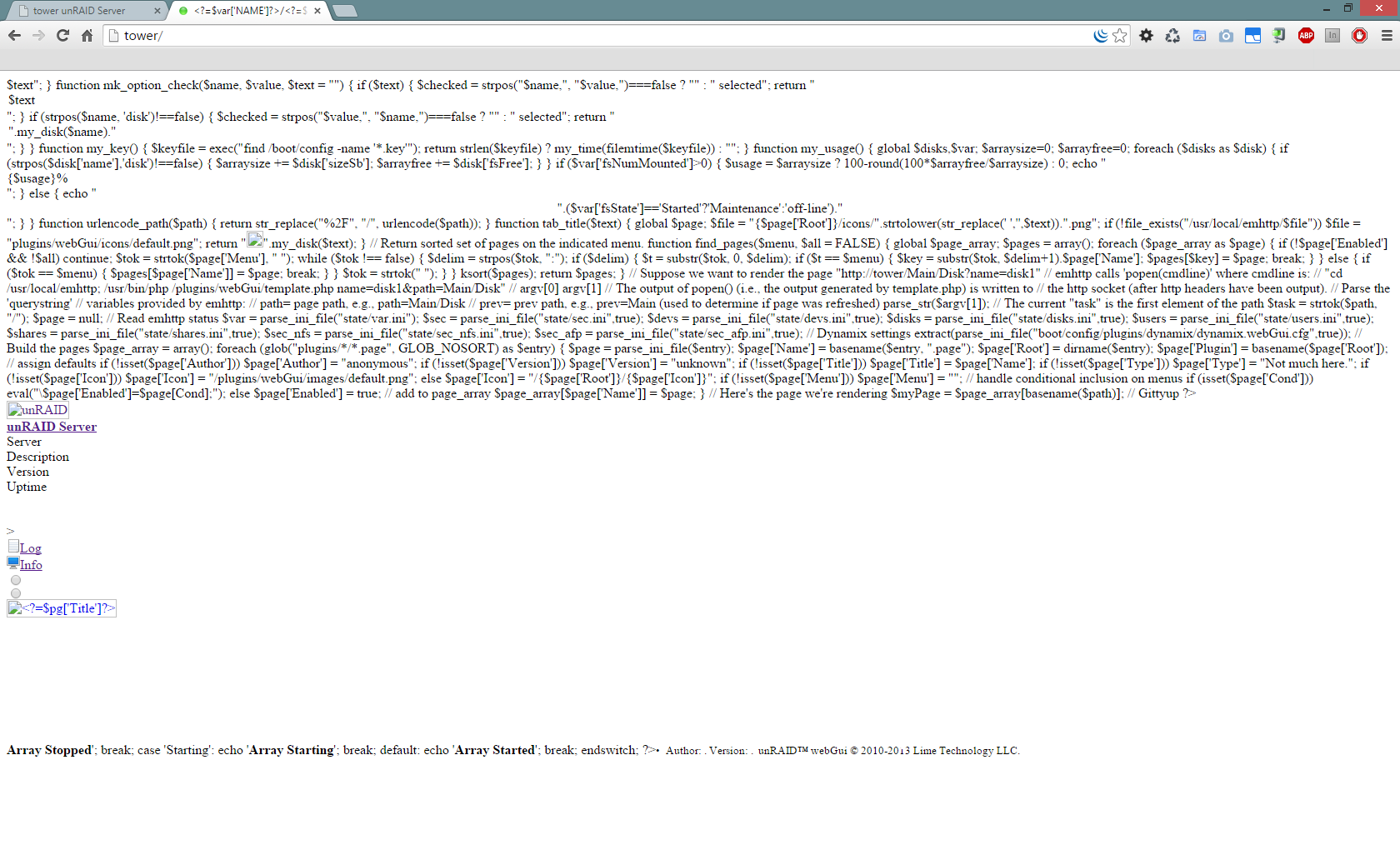

I'm having issues with the webGUI...UNMENU is working, the array is online and parity is valid.
I'm totally new to linux :/
Screenshot and syslog in the attachments
thanks

I've noticed a strange thing: the page seems to have white smal snowflakes falling down...maybe it's just my immagination, but moving the mouse seems to affect the direction of the snowflakes. It's like one of those scripts used on page during christmas time  :o

Do you have SimpleFeatures or Dynamix installed ?
Remove the folder /boot/plugins or /boot/config/plugins to uninstall the GUI and reboot your system.
Yes, Dynamix.
The problem is I've done a clean installation of 5.0.6 and parity sync is in progress.
I've got a backup of old installation files....After parity sync i'll try to replace the "new" unraid with the old one and delete the plugin folders to see what happens
