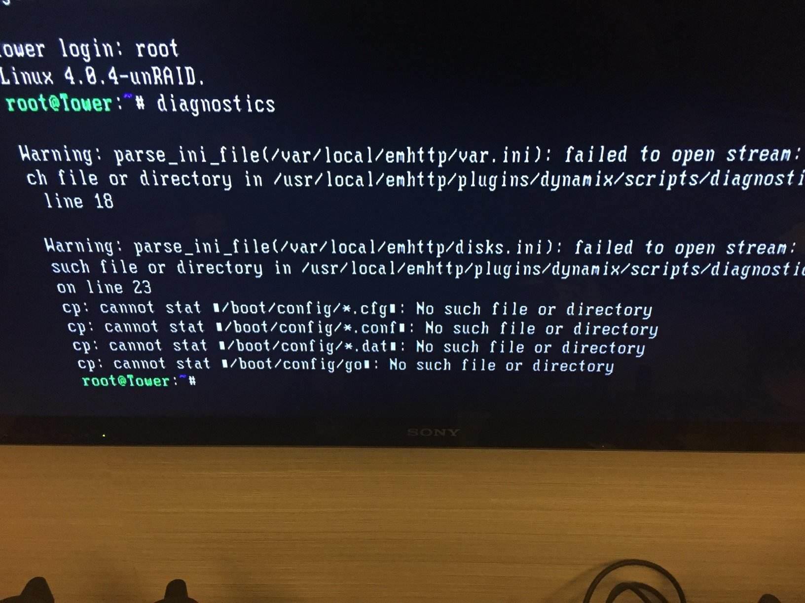

Ok, so I did exactly as you mentioned, but there is no diagnostic file on my flash drive.
I have also made sure hidden files are shown. This is what I get when I type diagnostics after logging into root.

The flash drive is missing the go file, which explains why the GUI is not accessible (emhttp is never started).
I recommend you rerun the installation of unRAID. See this video:

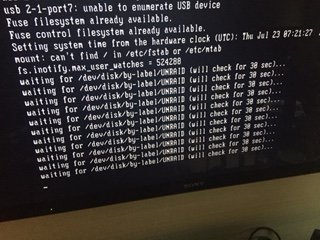

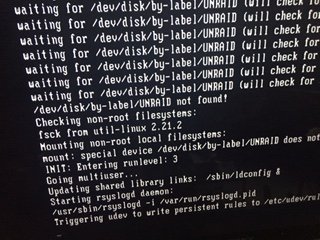

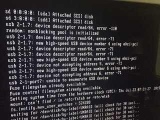

I've noticed on boot up, I get various errors now and then. I decided to take some photo's of it. I will post below.

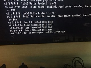

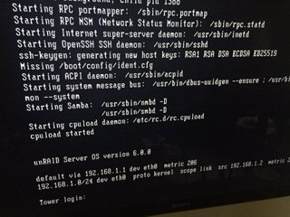

Gents, I have an ASUS H97I-Plus MB, I had some issues getting the system to log into the flash drive. Could any of the issues be caused by improper BIOS setup?
Anyway, here are some pictures of the error messages I get during boot up
And some more.....

Ok.... finally.
Gents, I went back into the BIOS and started changing a few settings.
To be honest, I just fiddled with a whole bunch of settings which I thought made sense.
Result... It now boots up without errors, and I can now access the Web GUI. Hurray!!!!!
