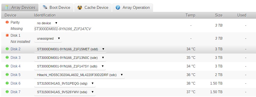

July 28, 201511 yr Hi Everyone, I think it's literally been a couple years since I last posted... Unraid has been so reliable. Well... Now I need help. The other day, I went to do my parity scan... and noticed a red ball on "Disk 1" (SN ending in 5W1G). Not a big deal, I had two drives already live on the system that had pretty much nothing on them (Disk 5 could easily hold everything that was on Disk 1). So I opened up Putty (for speed) and used Midnight Commander to move files from Disk 1 to Disk 5. It ran and ran... More than 24 hours - I knew it would take a long time... I wasn't worried about it. (I knew I'd later need to figure out how to remove Disk 1 from the set and rebuild parity, once the data was moved). I understand that Disk 1 had already failed and the "move" was from dataset/parity combination to Disk 5. Anyway, today I came home from work - and heard that evil hard drive clicking noise continuously... and errors on the Midnight Commander screen. So, I cracked the case, disconnected power and data to Disk 1 (not parity) and fired it up. In my browser, I now have an ugly scene: Disk 1 Not Installed (I think this is what is said before)... and Parity Disk and Disk 2 are now Missing (see attachment). I need advice on what to do to keep as much as possible of my data. As a possible aside, my last two drives are on a standalone SATA controller card - all the rest are on the motherboard. Maybe the MB has died? Thanks for your advice, Russell

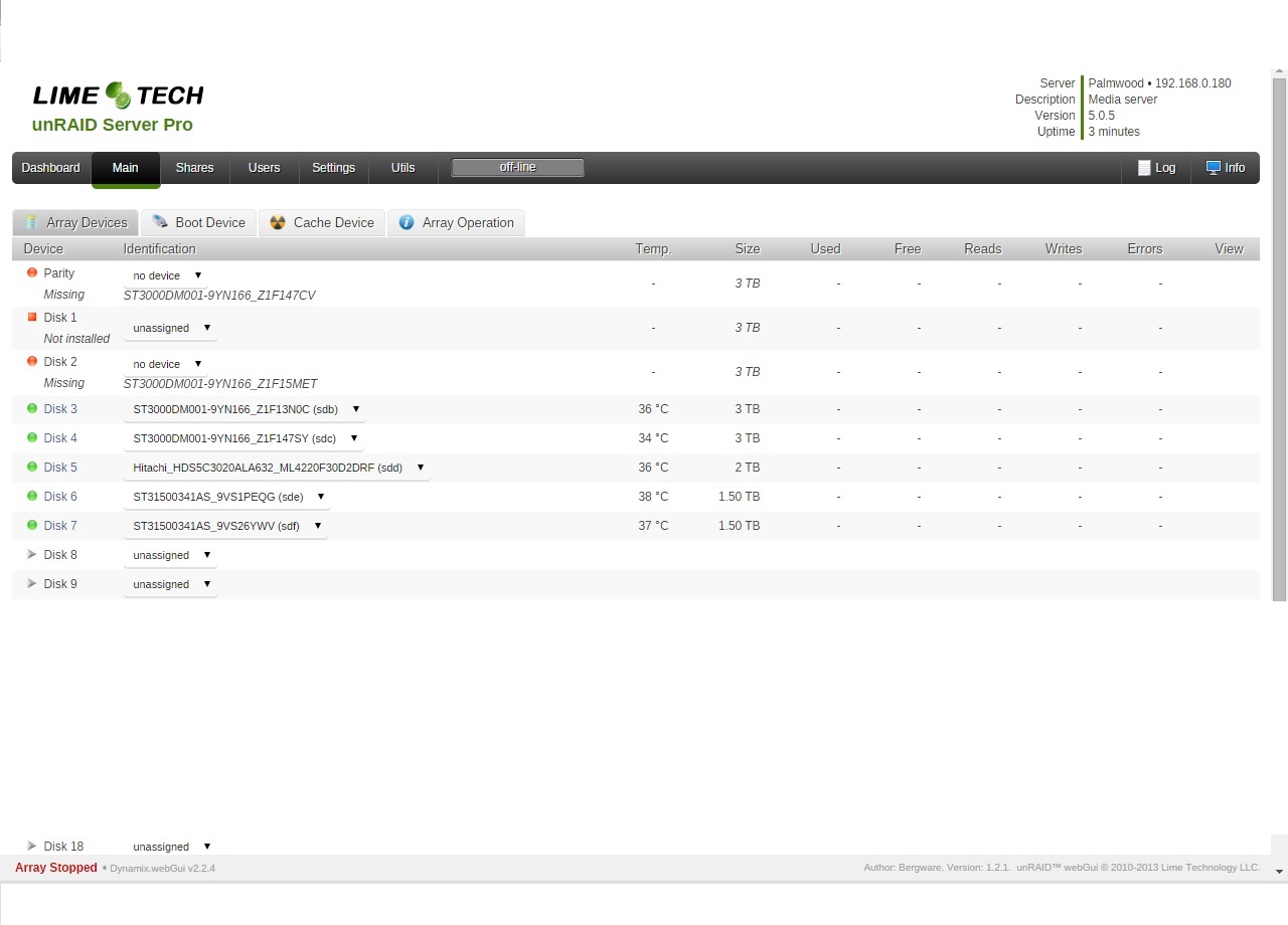

July 29, 201511 yr Author Thanks for the help. I took it all apart - all power and data cables to all the drives... and reconnected them to the seven presumed good drives. I tried a few combinations... The two drives that had appeared as Missing - I traded out new SATA cables and connected them to never-used ports on the SATA card (instead of motherboard). When Unraid Boots, I get three messages that say: sata7: link is slow to respond, please be patient (ready =-19) sata7: COMRESET failed (errorno=-16) And then this ugly one: sata7: reset failed, giving up When the web interface comes up, the results are a bit different (see attachment). Syslog was too big to attach - posted here: https://www.dropbox.com/s/guf7ptcycy0pr22/syslog-20150728-214241.txt?dl=0 Looking forward to more advice. :-) Thanks so much, Russell
