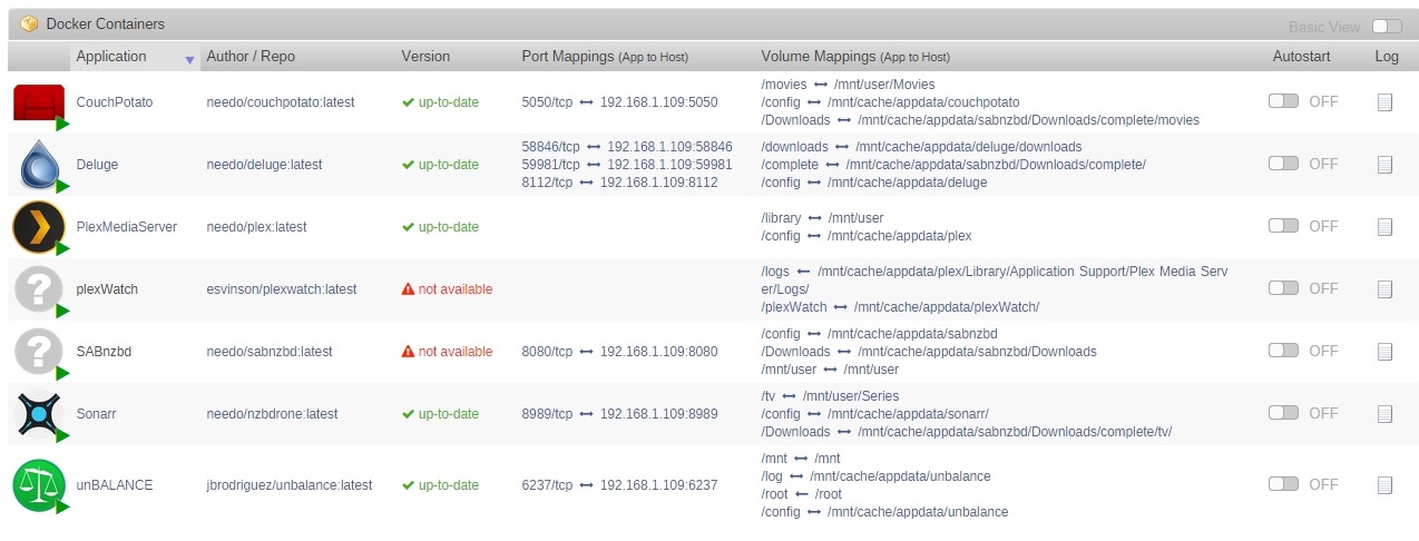

August 4, 201511 yr Hi, I am using the latest stable unraid and I am experiencing problems whenever i reboot the machine. When the system boots up, the dockers lose some settings. All the autostart switches dont remember the on setting i set. All dockers lose their icons (see attached SAB docker for example) until i re-add them. I dont believe this causes the individual applications to not function correctly, but obviously the update feature is lost when this happens. Also the user defined docker template list empties with every reboot. I have left SAB to take this screenshot before re-adding so you can see the issue. Am i missing something obvious? Thanks in advance

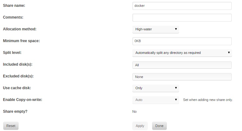

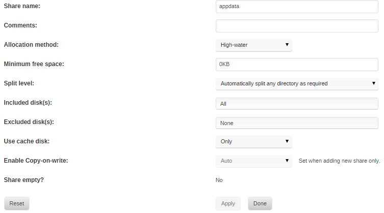

August 4, 201511 yr Author Thanks BRiT but both my shares (appdata and docker) are set to Cache Only. (see attached)
