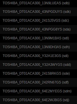

Nope must be new.  Here are my Toshiba Drives all appear to have unique last 4.
You are right - no repeats in last 4 chars - but they are no exactly random either.
The all end with "S".
A bunch of them end with "GS"

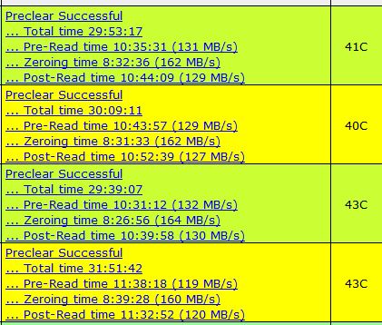

My preclear stats provided below. The bottom one was a little slower than the others. It as the highest sdx, and perhaps was slower due to running 4 simultaneous preclears. Or maybe it really is a little slower, not sure. Probably coincidentally, but the slower one's serial number is quite a bit different than the other 4.

Hmm I wonder why your preread is slower than the zeroing time. You got good speeds either way so I wouldn't worry or even put any time into it.
