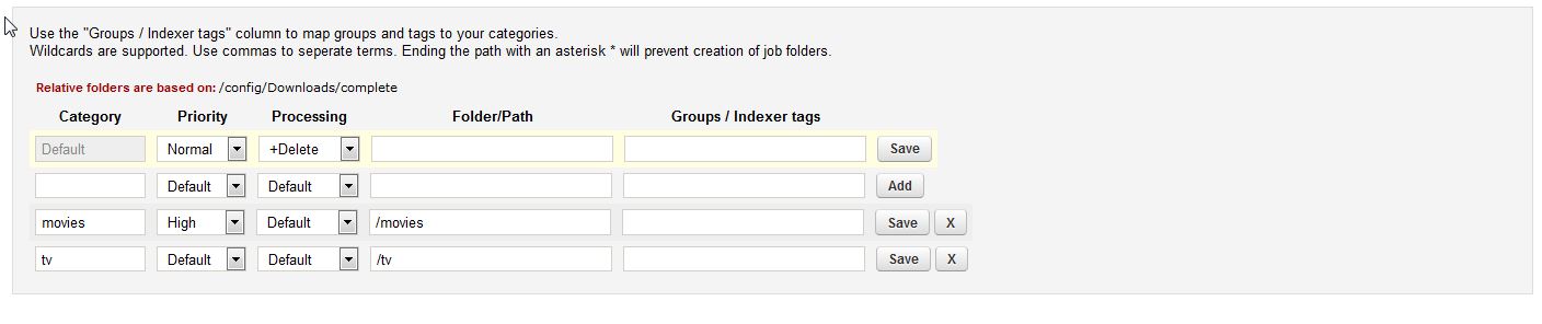

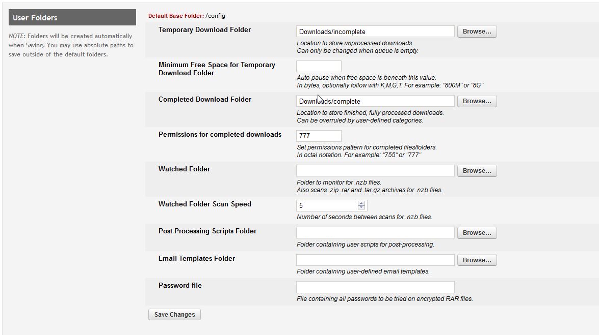

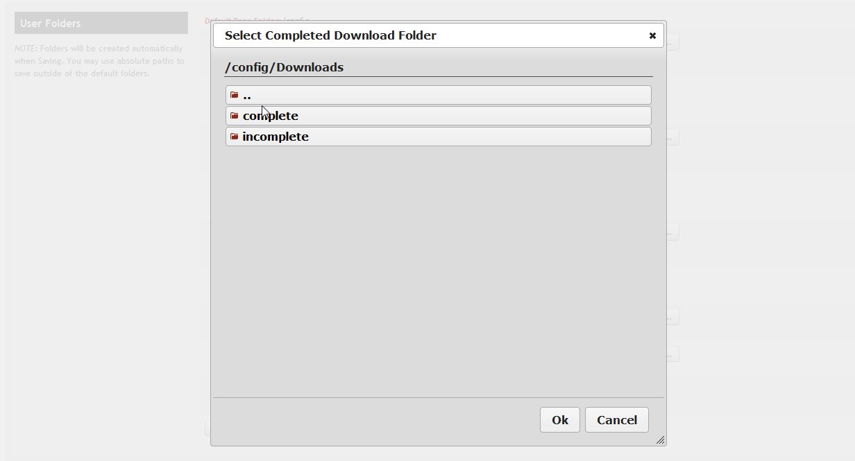

here's a few screens of the default directories that you are talking about - everything seems to be relative to /config which surprised me. But /config is mapped to appadata so I dont see it as an issue(?)

The last pic of your categories is where I see the problems (that are showing in Sab's logs)
Its telling you that relative folders are based on /config/Downloads/complete.
But you've given it /TV which is not a relative folder.  Sab will save anything from that category as /TV/showfilename.  And that's exactly what's happening in the log snippet:
ERROR:: write error ( in the file /tv/_UNPACK_Black.Sails.S01E05.720p.BluRay.x264-DEMAND/black.sails.s01e05.720p.bluray.x264-demand.mkv [R]etry, [A]bort)
if you change that to be TV instead of /TV then it will save it to /config/Downloads/complete/TV.
The incomplete files are still going to be going to /config/Downloads/Incomplete because you set that path to be Downloads/incomplete (first picture) which is a relative folder and is stored off of /config.

ok, Im trying to follow. I have changed the SAB categories folder setting to tv and movies (no more /)
On this point...
The incomplete files are still going to be going to /config/Downloads/Incomplete because you set that path to be Downloads/incomplete (first picture) which is not a relative folder and is stored off of /config.
...are you saying I need to correct this also? ie my incomplete/in progress downloads are not being stored outside the img on the cache drive? The thing is many individual moves etc are 15GB+ so I need them being downloaded outside the docker img.

That is correct.  Its relative so its being stored outside.
But you may or may not still have some corruption.  At the very least, I would delete the sab image (container & image) and then reinstall it from the my-sab template.  It'll be setup the exact same way as you left it, but will delete all the excess stuff that's gotten stored within the docker.img file.
