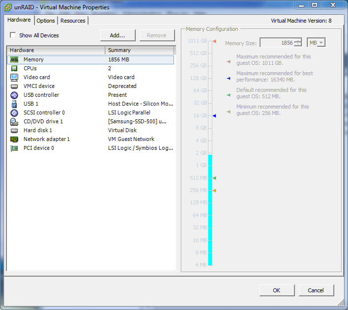

An observation - the system is allocated only 1.8GB.  That usually means about 200MB reserved for the graphics adapter, which isn't used in unRAID.  I don't know how you change that in your VM, but unRAID only uses a text console, only needs the absolute minimum setting available.  That would provide almost 200MB more RAM for unRAID.
I cannot tell whether it's a problem with the card, or with the driver, or with the way it's passed through, or some other incompatibility.  It's obviously not working though, in the current configuration.
I can certainly allocate more RAM.  My understanding was that it was not required, as I'm not using dockers, and other VMs within unRAID.  If you recommend I increase RAM, I can certainly increase it.
Without Dockers or VMs, you're probably fine with that.  I'm used to bare metal installations, not what's normal when virtualized.  I automatically react when I see a RAM number somewhat less than full gigabyte numbers, because it usually means wasted memory, memory reserved for a graphics adapter that won't be used, when it could have been helping out with unRAID caching or other things.  Now, you can help me learn - when you set up the RAM requirement for unRAID, did you set it to 1.8GB or 2.0GB?  In other words, are you limited to setting RAM in gigabyte increments or something smaller?
I'm using VMware ESXi, which is their "Enterprise-class" Hypervisor.  In a smart move, VMware lets you use that Hypervisor for free in small environments.  The configuration options are very granular.  I can allocate in very small chucks - I manually selected 1856 MB, as you can see in the screen shot attached below from the VMware vSphere configuration client.
