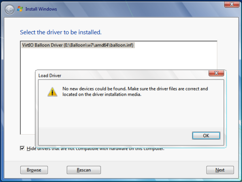

I can't seem to get the virtio drives to install.  I am getting the error shown in the image.  Is this normal?  What am I doing wrong?
I am trying to install windows 7 professional.  Here is the xml from the VM setup.

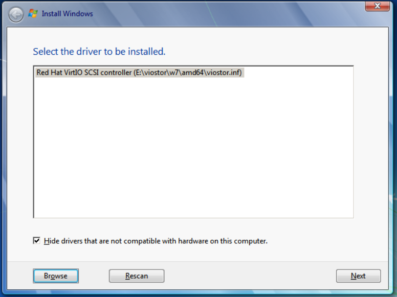

I install all 4 in the order on the wiki as shown below. But nothing happens after installing the fourth.  I am left with the attached screen.  They all say no new devices found.

Is this a 32bit version of Windows?
It is 64 bit professional.
Hmm, where did you obtain the installation media?
The windows iso comes from an old installation disc that I've used for years.  I believe it was originally a MSDNAA image.
Would that be the problem though? It seems like windows at least started loading fine.
The virtio image I downloaded today.
I used a TechNet image of Win7x64 on my test VM unRAID host and had no problems.  It's a TechNet image with the following name "en_windows_7_professional_with_sp1_x64_dvd_u_676939.iso".  Which leads me to ask:  Does your image include SP1?  If not could you try that or try slip streaming SP1 into yours if you don't have access to a SP1 image.  Pure guess so I could easily be wrong and of no help.
