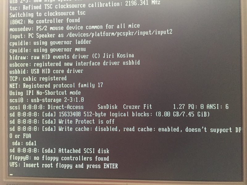

I needed to switch off my UnRaid NAS, so I used the GUI to "Stop" the array, then logged in using Telnet and did a shutdown -h now
I daresay the system had been up for months, if not over a year. No errors reported on any hard drive.
Now It now won't reboot  :( I get VFS: Insert root floppy and press enter.
So I tried to reboot in the "no pluggins" mode whatever that is, and it got to a similar point and just hung.
Please help - I don't want to be an expert user or do anything fancy, I just want a NAS where I can dump my files!!

What happens if you "press ENTER"?
Kernel panic.
