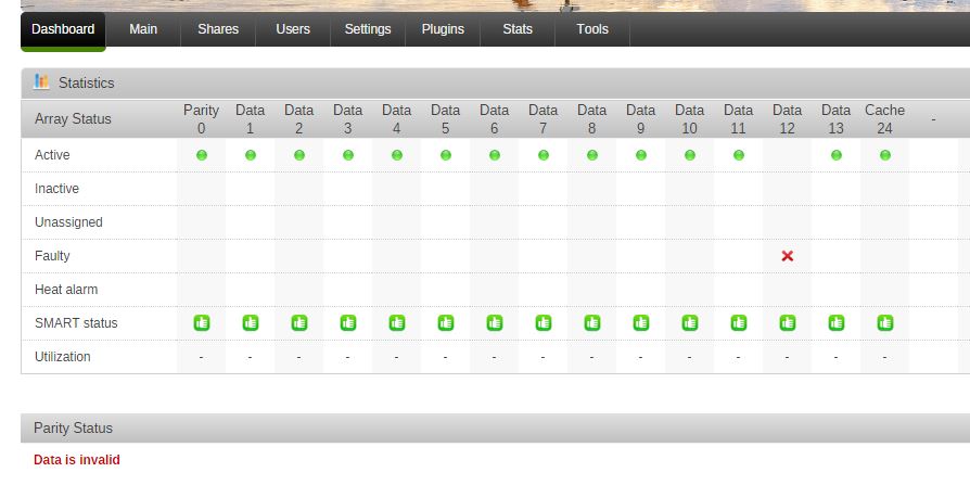

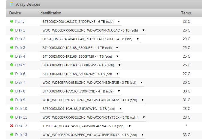

Well that  is not good.  In that main page it says configuration valid, and on the dashboard under parity status it has data is invalid.  So is it worth trying to rebuild or is it just not going to work.  And if it is not going to work i just need to uninstall the bad drive and install a new one and do a parity sync to get back to working, then transfer off the old drive from the windows computer.  And what caused this big of a failure with just one drive having problems???  Thanks.
Okay -- you said parity wasn't valid, but you've just somewhat conflicted that.
What is shown on the Main tab?  i.e. does parity have a green ball?    If you simply aborted a parity check, that does not invalidate parity.  Not sure why the Dashboard is showing something different (assuming there's a green ball on the main tab).
The key thing right now is to do NOTHING that will write to the array.    Post a picture of the Main tab.
Here is the the main page shot and the dashboard.
Here is another snap of the config that I missed in the first pic.
That looks fine => there's nothing on the Dashboard about parity being invalid ... it just shows that the data on disk 12 is invalid.  ... and parity shows as good.
So ... you simply need to rebuild Disk #12.
Stop the array;  un-assign disk #12;  Start the array so it shows as missing;  Stop the array and power down;  replace Disk #12 with a new disk;  Boot & assign the new disk as #12 (You'll have to stop the array if it's set for auto-start);  then Start the array and let it do the rebuild.

I did a quick rebuild on my test system to see what you were referring to r.e. the "Data is invalid" message ... and I can understand why you thought that was referring to Parity, as it's immediately below the "Parity status" note.    That is indeed a bit deceiving => it clearly means you no longer have a parity-protected array because there's a drive failure ... but it does NOT mean the defective drive is the parity drive.  You have to look above that to the line labeled "Faulty" to see which drive is marked as bad.
... or look at the Main tab, where the red-ball clearly indicates the bad drive.
That status info could be improved  :)
