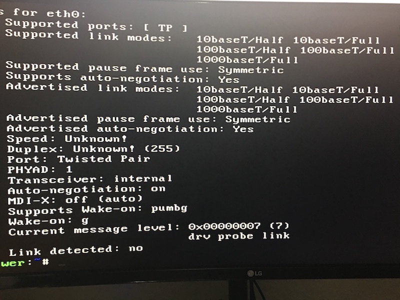

From console
ethtool eth0
This is the result.
