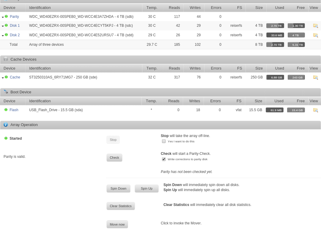

Please post a screenshot of Main, and also go to Tools - Diagnostics and post the complete diagnostic zip.

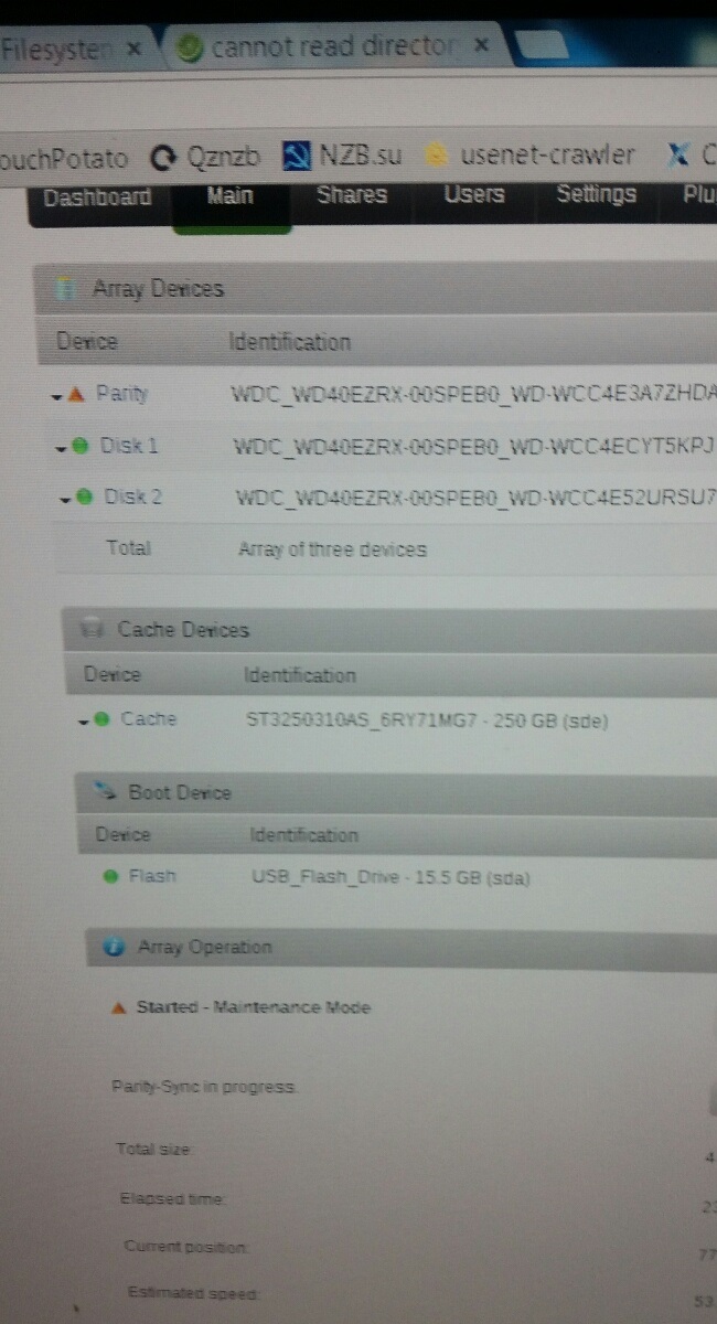

the diagnostic is attached here is a screen shot, would you like another diagnostic download? I'm currently running Check Filesystem Status. reiserfsck 3.6.24. I'm not sure about putting a data disk in parity but I think it happened. Not sure the command I used to recover the lost data.

No diagnostic attached. Also screenshot looks like it was done with a camera, is incomplete and mostly useless. I was hoping to see what unRAID thought about your filesystems.

picture of main page
Tower_Main.pdf

The screen shot shows that you are running in Maintenance mode.  In that mode you cannot access any of the files on the disks (unless you know how to mount and access disks from the Linux command line level).  You need to stop the array and then restart in normal mode to be able to access the files.
Sorry old picture I'm out of maintenance mode now
