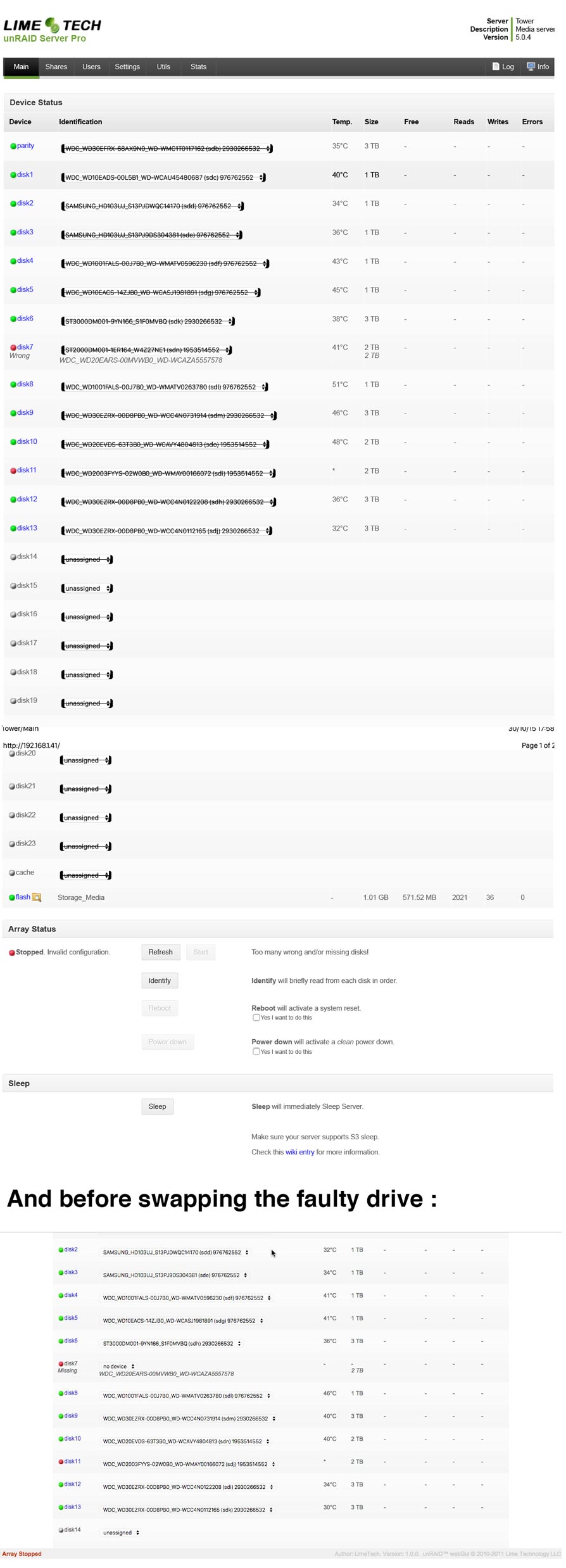

So,
I'm trying to deal with an iffy one.
I've got two failed data drives.
One of the two seems to be okay-ish, or so says smartctl (I'll post the report at the bottom of this post). This is the one that red balled first - I'd suspect ButterfingersMcIdiot here hit a cable on the way to trying to figure out which fan that was making a weird noise. Of course, the array was happily writing some truly trivial stuff right then.
A 2nd one was throwing write errors. So I figured I might as well try to copy everything off both drives to an external one. This was the kiss of death for drive 2. I tried reviving by switching slots and everything, to no avail - kaput.
So now, I have two dead drives, one of which is _really_ dead, and the other one that smartctl says should be able to limp along, at least for now.
The completely dead drive has been replaced with a fresh, identically-sized one.
Now...
Anybody know what the procedure on 5.04 to try to loose as little data as possible would be ?
Also, here's smartctl -a for the zombie drive.

Thanks for the quick reply !
The current state of affairs is on top.
The bottom is pre-swap of the drive that was throwing errors.

Take a screenshot of your Main page so you will know which disk goes where, since New Config is going to clear all the assignments and you need to put them back exactly.
We'll have to work through this a little bit with the webUI as a guide as I don't remember all the details exactly.
Go to Tools - New Config and it will let you define a new disk configuration. The reason we need to do this is to get unRAID to use the disabled disk11 and so we can avoid having it rebuild parity against the blank.
After you assign the drives, including the new disk, there will be a checkbox that will tell it to not rebuild parity or trust parity or something like that and you should check the box.
When you start the array, it may start to check parity anyway. Stop it as quickly as you can.
After you have stopped the array, unassign the new disk and start the array again. At this point, you may be able to see if unRAID will let you browse the emulated disk. Possibly it won't really be able to mount it if it is corrupt.
Just go this far and let's see what happens. Ask questions and post screenshots as you go as needed.

The array is stopped right now.
Am I right to assume that the next thing to do is essentially to unassign parity, start the array, stop the array, and restart to rebuild parity based on the rebuilt drive ?
Yes. Since you repaired the sd device, you have invalidated parity. Usually we work with the md device, which will include parity with the repair so it would have remained valid.
