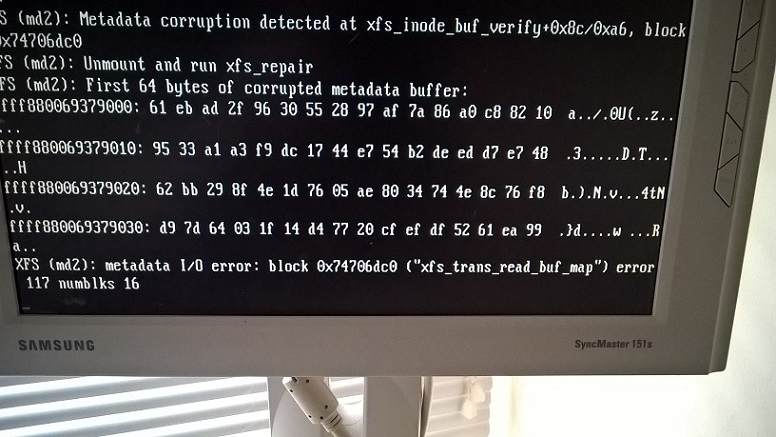

However on a monitor which I have attached to my Unraid array, a continous scrolling message is showing:-
XFS (md2) Metadata corruption detected at xfs _inode_but_verfify+0x8c/0xa6, block 0x74706dc0
XFS (md2) Unmount and run xfs repair
XFS (md2) First 64 butes of corrupted metadata buffer
A whole load of Hex numbers that I can't read as the screen is scrolling too fast
XFS (md2) : metadata I/O error: block 0x74706dc0 ("xfs_trans_read_buf_map") error 117 numblks 16
The data rebuild percentage is moving upwards, I assume that the array is rebuilding and carrying out an XFS repair. As such I guess I have to leave it running?
I have been running UnRaid since V3, and this is the first time that I have seen error messages where disks have been replaced / array rebuilt
See attached screenshot

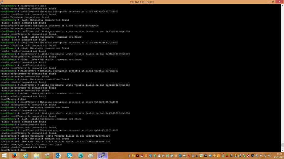

I have complete this using xfs_repair but without the -n option
Pleaase see attached screenshot, as it looks like commands can't be found
That type of error should never happen.  It implies that there is something wrong with the OS level files in RAM.
Things that I can think of that might cause this:
  • Borderline RAM.  Running a memory check could help with diagnosing such an issue
  • Plugin that is loading incompatible libraries/files.  Starting unRAID in 'Safe' mode from the boot menu should stop plugins being started.
  • Files being loaded via the /boot/extras folder that are incompatible.

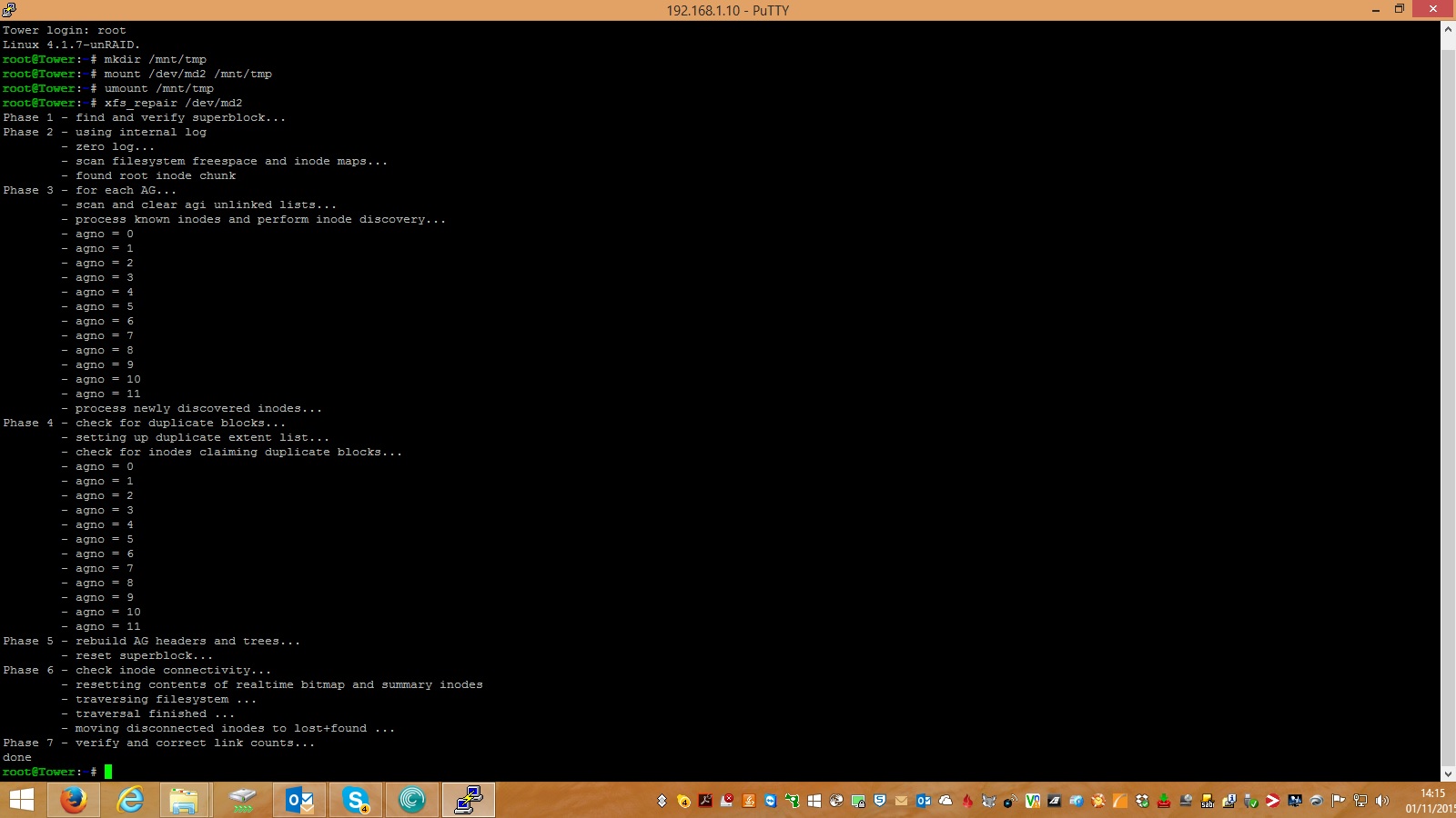

I have run your same commands, and it appears that it has worked this time, see attached screenshot
I have then stopped the array restarted in normal mode, and the arry is rebuilding fine now with no messages on my monitor
