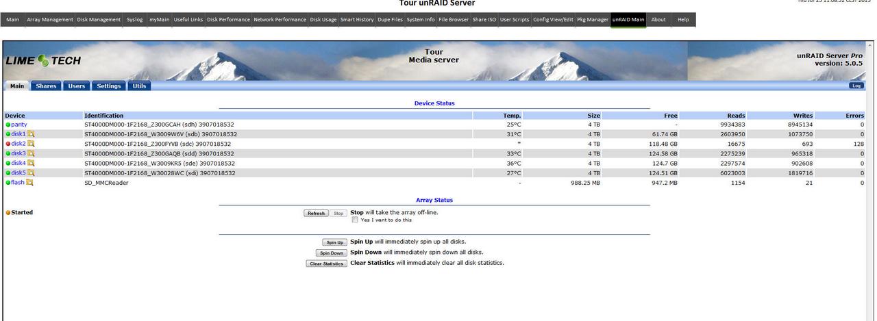

Some months ago, one of my 4TB HDD seems defect on my unraid 5.0.5.
Red ball, 128 errors, unraid server has stopped this HDD.
So I've simply swapped this HDD for another new one, and I should send this HDD back to Seagate for fix it.

- Main unraid capture, with the HDD fail (FYVB).

The commonest cause of a disk being 'red-balled' seems to be issues with the power or SATA cabling that cause a write to fail rather than the drive itself being defective.
Nothing but speculation at this point. A syslog that included the redball event might have told us something. Often a drive is redballed for something other than the drive, such as a loose cable or power connector. All a redball means is a write to the drive failed for some reason, and it must be rebuilt. It must be rebuilt because that failed write, and any subsequent writes, are in the parity array and not on the disk.

For some reason, I look at main status in july and, after grabbing the syslog and a picture of the main screen, assigned the failed HDD for another one already connected inside the server and I've removed the "bad" HDD some days after the swap.
Now I've put the "bad" HDD in the same place as before, launch preclear on it and it seems that everything look fine.
Maybe an issue with power, sata cable...
