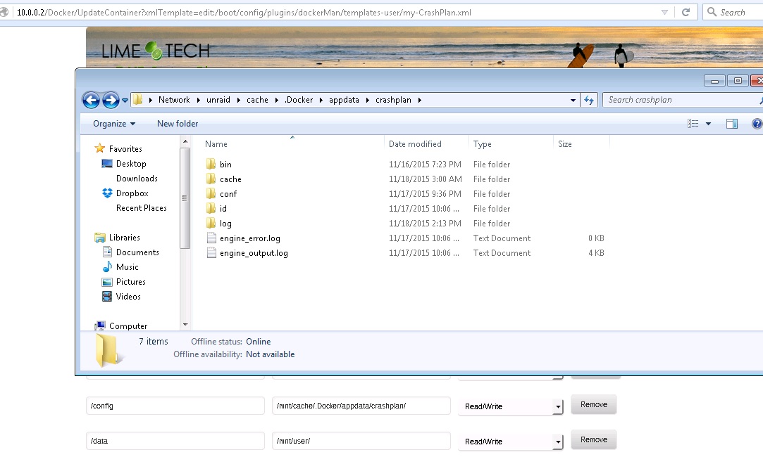

First I would check that the configuration files for the CrashPlan container still are located where they should be. My mappings for these are /mnt/user/appdata/Crashplan (also see the pic). Yours might be different depending on what you have set on your system depending on if you have the files on a cache drive or on the array. Have a look on next pic to see how it would look like. You can also have a look on the history.log file in the log folder (and take the one with latest modified date) to see if the if the backup is running or when it stopped.
If the files that should have been in the CrashPlan folder isn’t there it might be that you are using a cache drive and haven’t set the appdata share to Use cache disk: Only. Then they have been moved to the array.

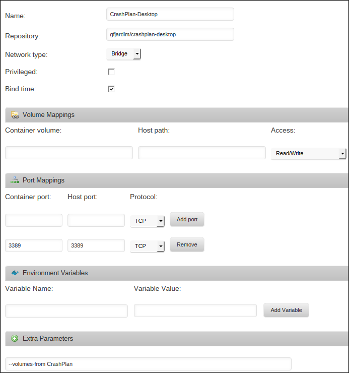

Check that your CrashPlan Desktop settings are as the enclosed pic, especially the Extra Parameters.
holy crap...out of habit, I had a /config directory mapped for CP-Desktop.  I removed that  and the app launched.  But now its telling me that it cannot connect to the backup engine....  So we are getting somewhere.
