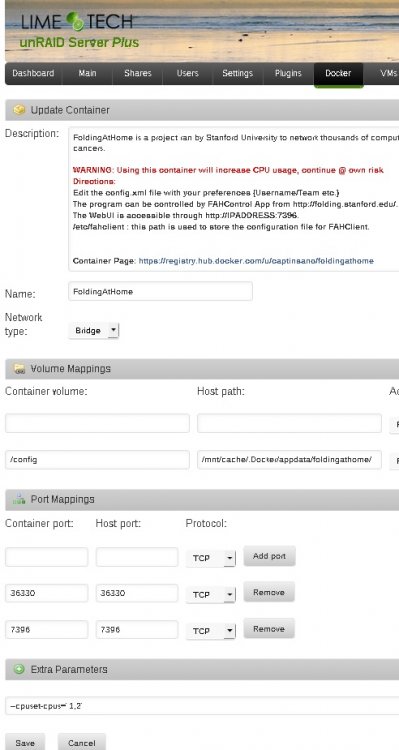

  14. Check out the edit I made to my previous post. This config goes right into the Container Config. You dont have to touch folding@home at all
  15. I believe the universally accepted way to is use "CPU Pinning" with the F@H docker container. I gave F@H 3 of my 6 cores, and my CPU bounces between 40-60 percent. Is that what you are looking for? EDIT: Actually I lied... I am only using 2 cores. This line goes into "Extra Parameters" in "Advanced Settings" --cpuset-cpus="1,2" Keep in mind that CPU Count starts at 0. In my case, Core 0 is being used for a VM. So I have a 6 core CPU. Core 0 - VM Core 1,2 - F@H Core 3,4,5 - Plex Since 0,3,4,5 should really never been at 100%, unraid still works fine. You will find though that 1 and 2 will be at 100 most of the time. All clear?
