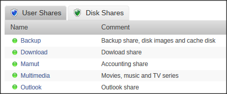

I believe I am using disk shares only. Not sure what user shares are. I only have kept a single user, root, on the server.
A User share can span several disks but a Disk share is assigned to a single disk (has nothing to do with user accounts).
Then I have plenty of user shares. Why would this be a problem? Basically I setup an unraid folder on each drive, and I place movies and tv series in two subfolders. Once each disk fills up, I move to the next one and maintain the same directory structure.

With the setup you describe you should be fine. Some have their individual folders split over several disks so if you have a folder with several files (movie, subtitles, posters etc) they can actually be located on different disks.

You can use Windows to delete all folders and files and once your user share (the top level folder) is empty you can delete it in User Shares (unRAID GUI).
