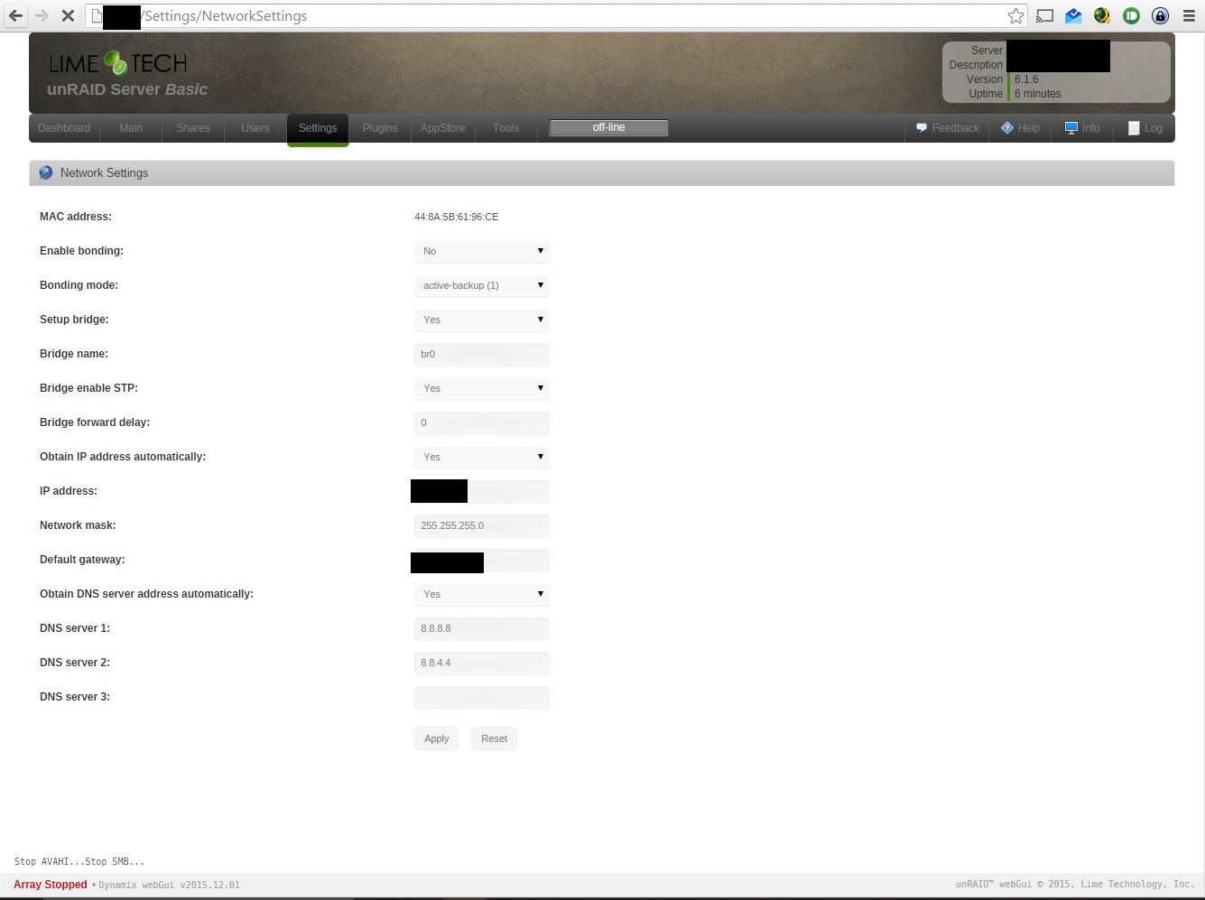

Failure to enable br0 (Network Bridge)
For setting up VMs I have tried to set up a public network bridge.
This was unsuccessful: whenever I try to enable br0 (or br1 or whatever I call it) the webinterface gets stuck and nothing happens. Any Idea what might go wrong? Could there be a conflict with docker's bridge? (hence I have tried br1 out, br0 was also not working).
I have waited a good 10 Minutes and nothing happened

Setting a static ip under \flash\config\network.cfg enabled me to set up a bridge.
No idea what conflicted with my just using dchp...
