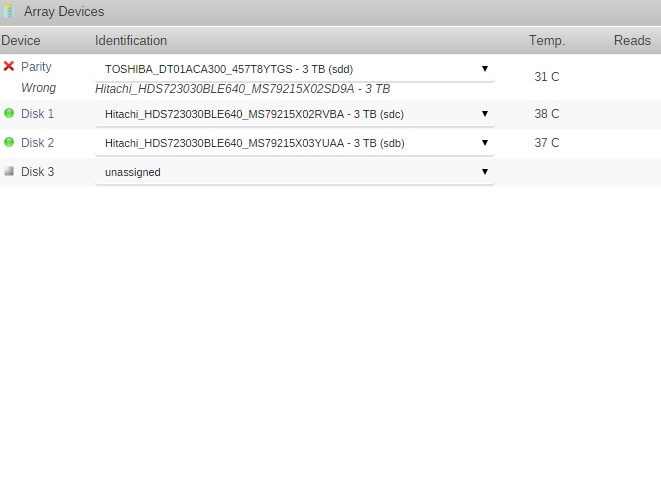

So I've swapped the disk, changed the name in the main array devices.. Its says Wrong as in picture.
What do I do now ?
Start array to begin parity sync.

johnnie.black has the correct advice for you but just wanted to clear some things up about your OP.
The only time a disk is required to be clear is when it will be assigned to a new data slot. This is so parity will remain valid. People often preclear new disks even if they are not required to be clear just to test them.
The filesystem is irrelevant in this case because the parity drive doesn't have a filesystem.
All of these steps 1,2,3,4 could have been combined to just Stop array, assign new parity drive, start array and rebuild. Possibly you would have shutdown after stopping to install the new parity and possibly remove the old parity, but none of that is actually required. Just assigning a different drive to the parity slot is all that's needed to make unRAID build parity to it when you start.
Thanks everyone.
Parity all good, just running full smart to be sure.
Next step, a new data disk.
