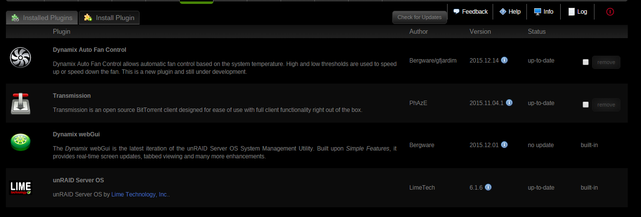

so i started re-setting up everything and when i go to the plugins section i can only see the unraid os and the web interface so i thought ok ill reinstall the plugins but when i try to do that i get an error like this
Warning: simplexml_load_file(): I/O warning : failed to load external entity "/boot/config/plugins/recycle.bin.plg" in /usr/local/emhttp/plugins/dynamix.plugin.manager/scripts/plugin on line 193
plugin: xml parse error

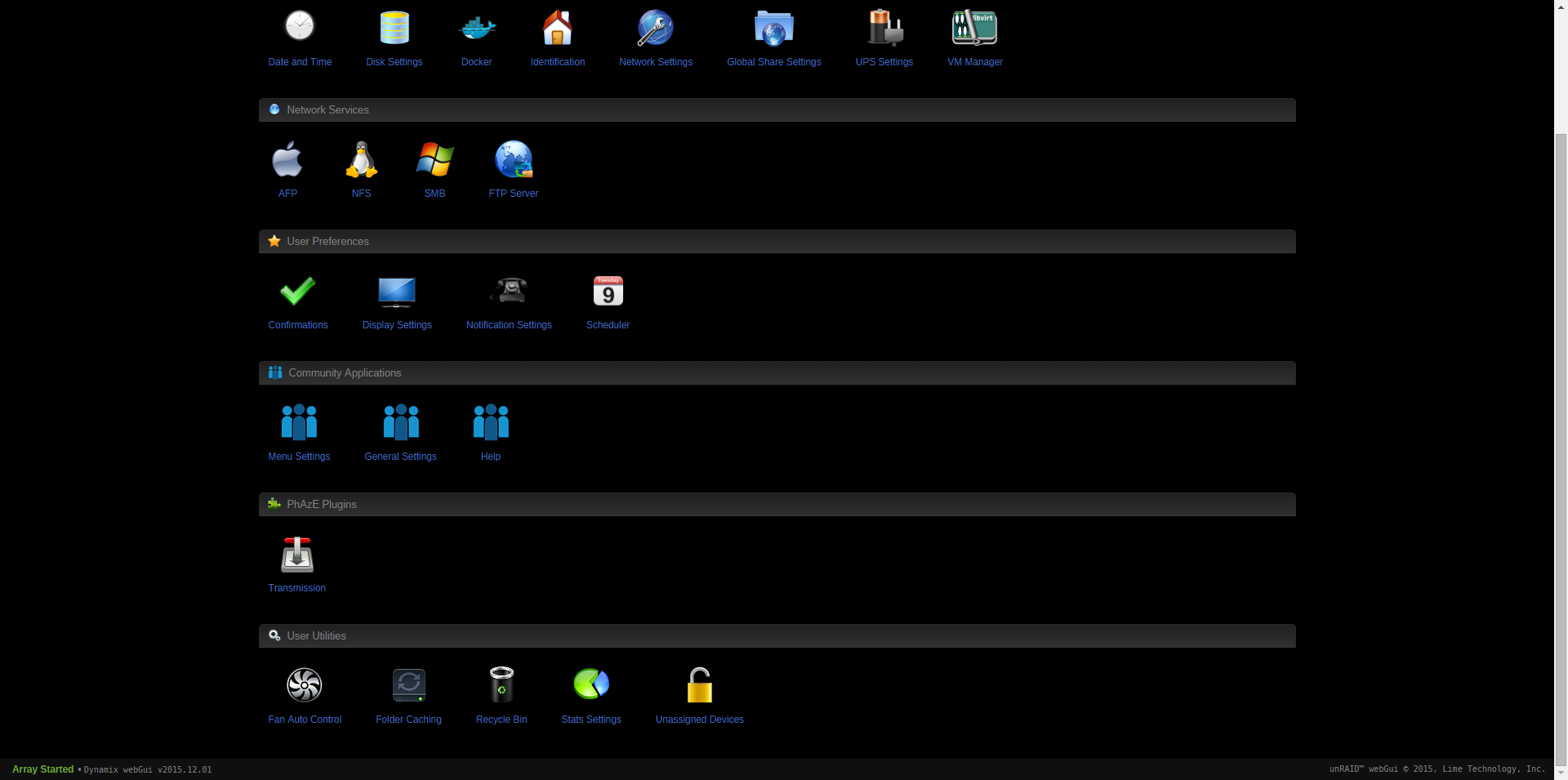

if i go into the settings menu i can see the plugins but obviously they dont work. so it seems the plugins are still in the web interface but are missing files.

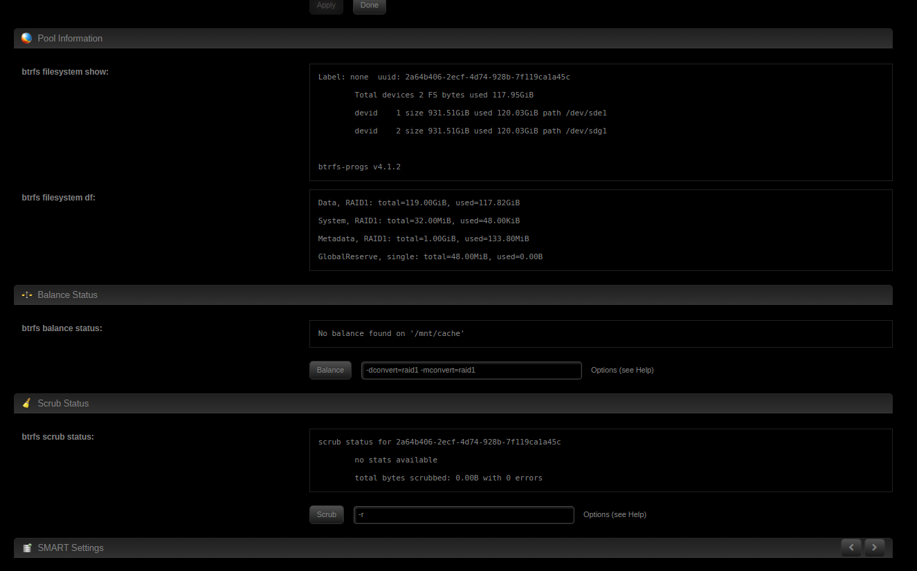

Some other things later in the syslog about btrfs that make me wonder if there isn't some problem with your cache pool.

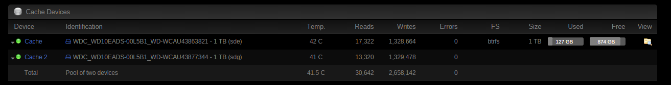

Post some screenshots showing your problem and maybe some screenshots about your cache pool.

So do you have only the one correct unRAID USB plugged in now and you rebooted without the other one?
What exactly do you think you are missing? Screenshots look normal to me.

i had about 10 plugins installed before and they are all gone.
i can see stats,recycle bin, folder caching all under settings but they are no longer under the plugins section and every time i try to reinstall any of them i get an error similar 2 the one mentioned with the recycle bin.
