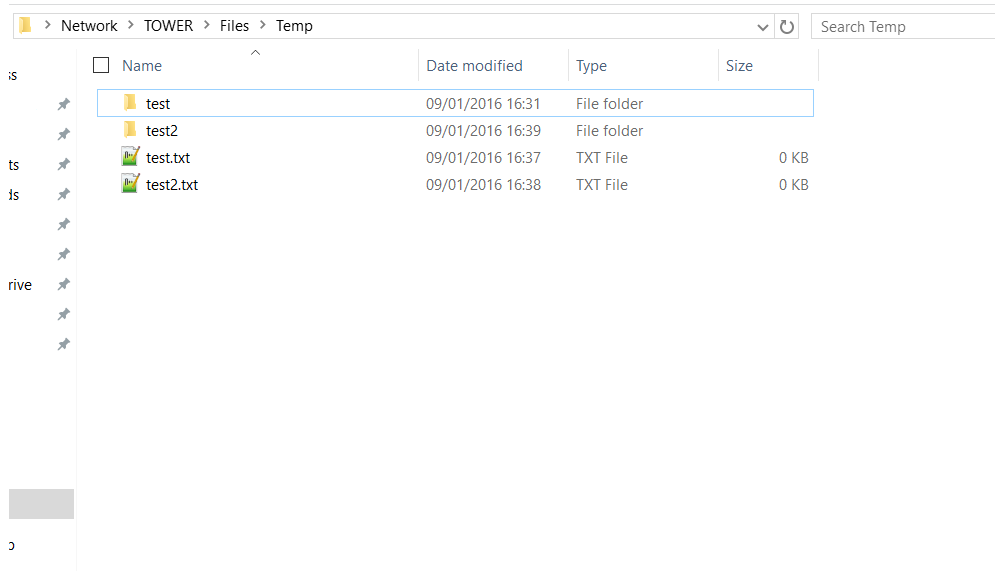

location still contains files: see attachment.
Any other suggestions, I am willing to try anything!! (please no suggestions of just use SMB to mount instead of 9p, there is a reason I need 9p to work!)
