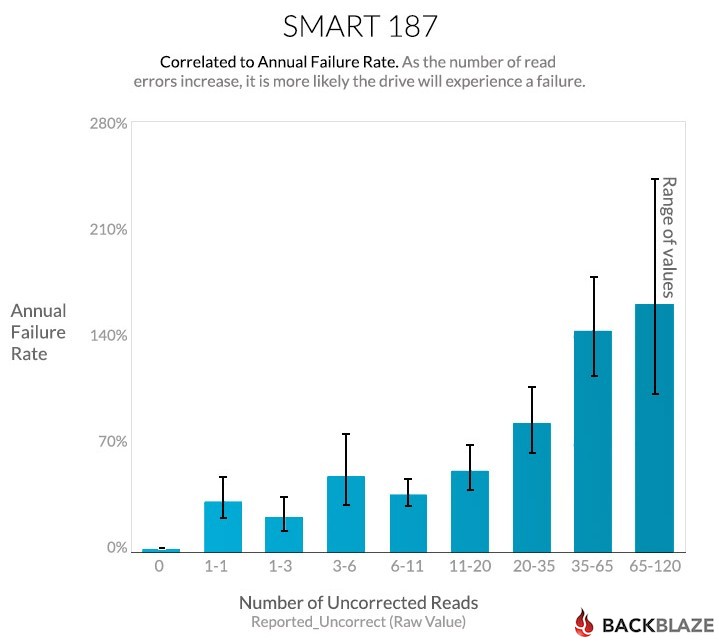

I agree with itimpi that you should try a rebuild first, but that disk has a SMART error that usually means a higher probability of failure, keep an eye on it, and if it redballs again replace it.
187 Reported_Uncorrect      0x0032   099   099   000    Old_age   Always       -       1
