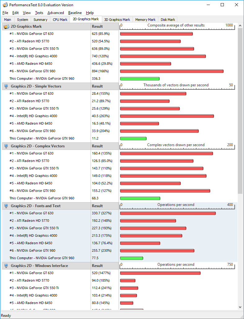

Poor 2d graphics performance in Win10

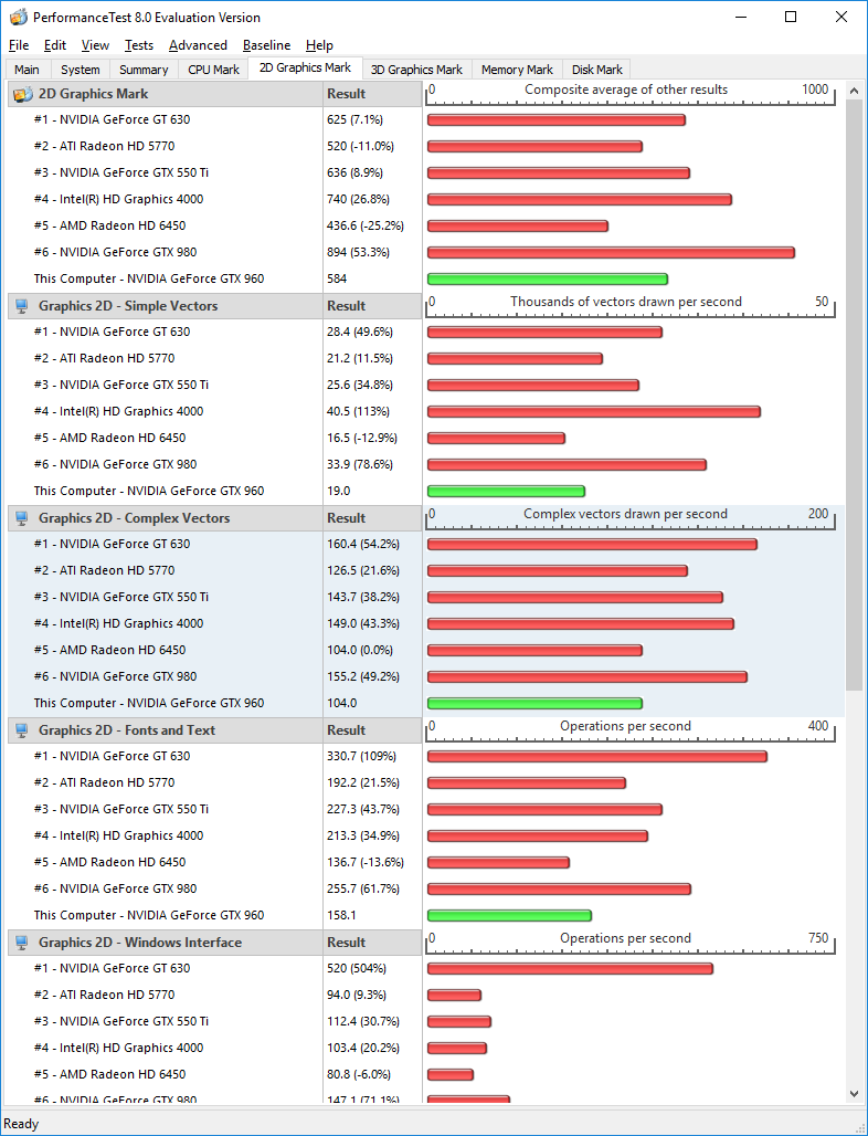

I ran some tests yesterday between VM and baremetal. 3d performance takes about a 10% hit, which isn't all that unexpected and I can live with. But 2d performance takes about a 50% hit across all the tests, and it's quite noticeable when moving/resizing windows.
Is there anything I could look into, or some tweak I could do to improve this?
GTX960/Win10/OVMF
