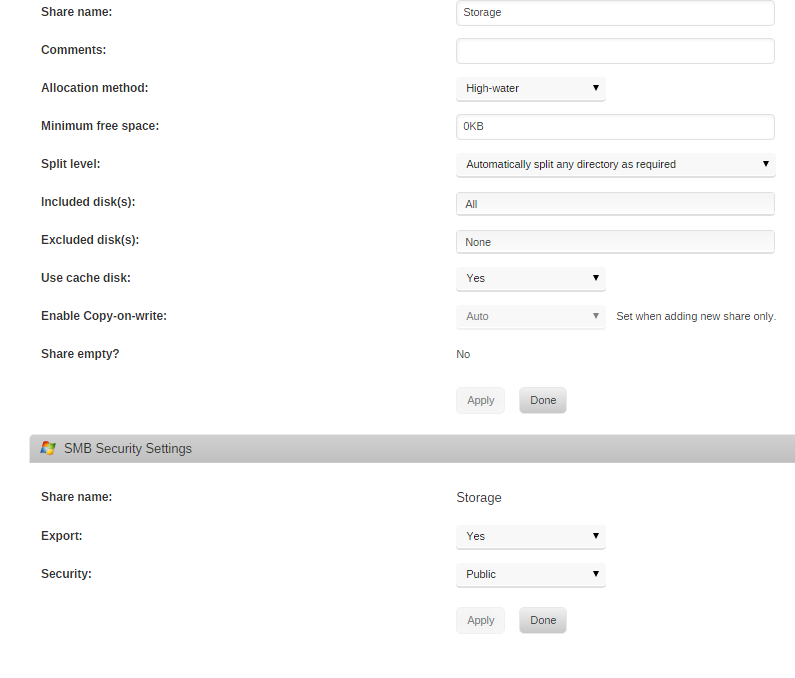

I created a share, wondering on the best setting for it.
I left everything on default, set Use Cache disk as Yes

Sounds like speeds you would get writing to a parity-protected disk, not to cache. Are you writing to a cached user share?
I attached the Shares page in the picture.

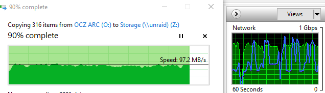

I found out how to format it, the cache drive filesystem was set to auto, i changed it to XFS and now its giving me a format option, will test once its formatted
Edit #2:
Transfering a 40GB folder with multiple files in it, im running 80MB/s to 100MB/s and peaking at 90% network utilization. Transfer is suppose to take under 8 minutes. So im feeling better about this now. i didn't realize my cache drive was just doing nothing.
