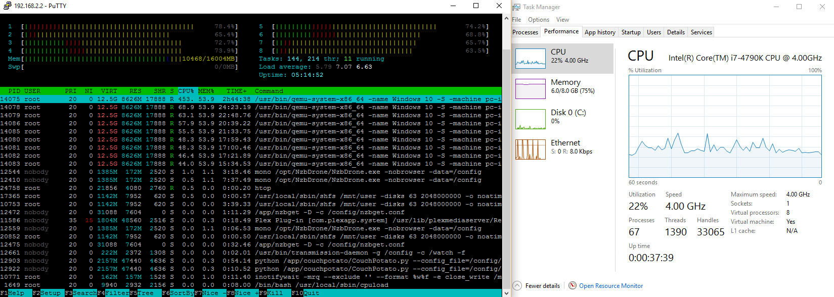

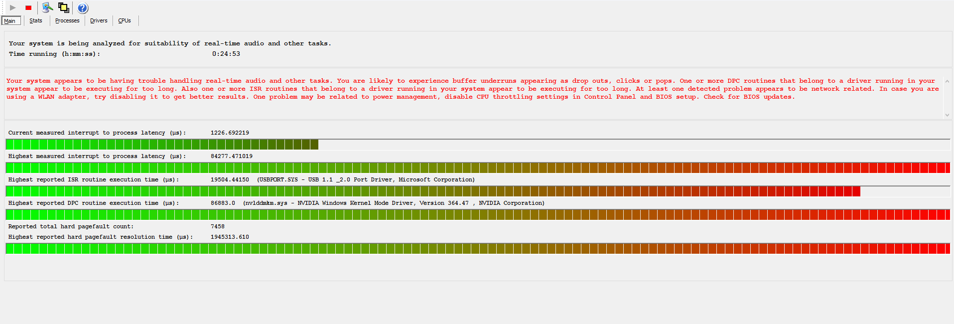

I'm not sure entirely what is going on, but my dpc interrupts are really really high and the cpu usage on the os vs unraid is really disproportionate. The system is still a little laggy - it turns out enabling msi interrupts completely fixed the graphical problem but now it seems to still be a little laggy occasionally.
