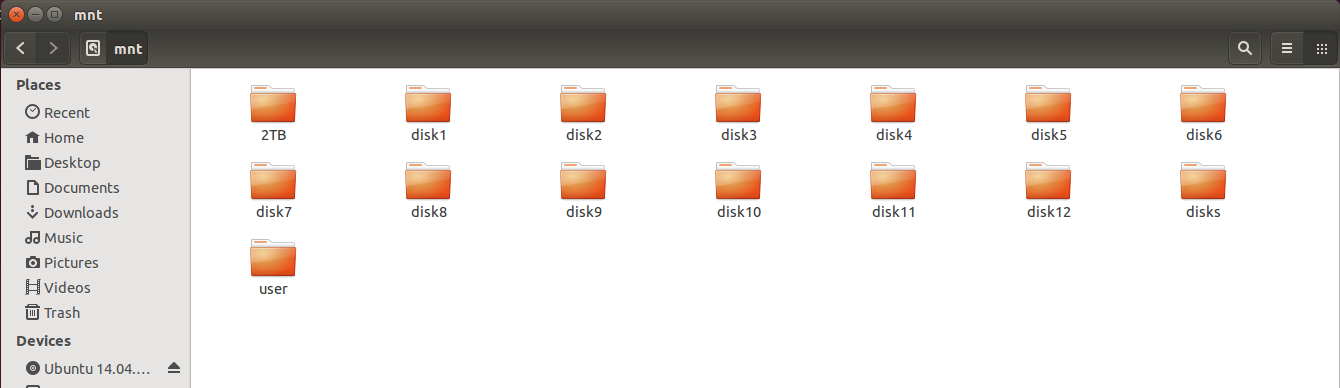

I just noticed this a few minutes ago. Could be the update. Not sure, but I never had an issue seeing my shares within my VM. That's how my Crashplan has been working for several months. I would just usually open up the /mnt folder within the VM and see all my shares in there. Any ideas? The attachment is what I normally see.
Here is the line I added to my /etc/fstab file within my Ubuntu VM.
unraidshares /mnt 9p trans=virtio,version=9p2000.L,auto,nobootwait,rw 0 0

Does it work if you add _netdev to the options in fstab? The underscore is a part of it and not a typo  :)
Thank you. After several reboots my unraid mounts always appeared. Looks like this may have taken care of it. Very nice. I'm not sure why they aren't in a folder called "unraidshares" but having them show in /mnt is just fine for me. I see all the individual drives, and most important the user shares, which I use to backup the entire array.
If you want them in unraidshares just change /mnt to /unraidshares in fstab  :)
Thanks
