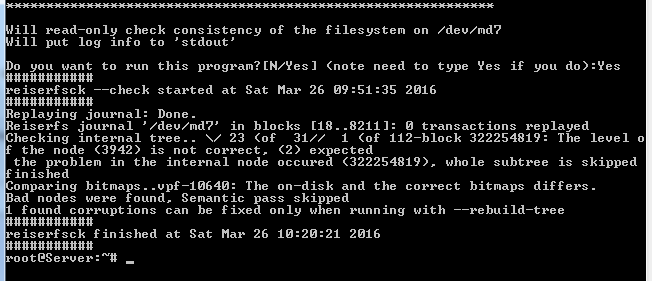

I am hoping that someone could take a look at the attached PNG and help me understand the results and perhaps advise with the next step (I can't copy & paste from the command interface in Windows, sorry).
EDIT: It seems that because it is suggesting that I use the --rebuild-tree command, that I should follow the instructions found in the Wiki, right?
From the Wiki:
At the conclusion of the reiserfsck --check command, a report will be output. If errors are detected, this report may specify an additional action to take. The most common ones are to re-run reiserfsck specifying the --fix-fixable switch or the --rebuild-tree switch, for example:
reiserfsck --fix-fixable /dev/md1 [answer with Yes when prompted. (capital Y and lower case es)]
If your file system has only minor issues, then running reiserfsck --fix-fixable should be all that is necessary.
Important Note!!! Do NOT run reiserfsck with the --rebuild-sb or --rebuild-tree options, unless you are instructed to by the output of a previous run of reiserfsck or by an expert user! They are last-resort options, to repair a severely damaged Reiser file system, and recover as much as possible. They rarely repair the system to perfection, and there may be a little data loss. They do a great job, and make the drive usable again, but it's possible files may be lost or damaged, or moved into the lost+found folder. The --rebuild-tree option will almost always create a lost+found folder and place in it the files, folders, and parts of files it can recover. It will then be up to you to rename them and restore those files and folders to their correct locations. Many times, it will be possible to identify them by their contents and size.
Sorry for my caution--I just don't want to make a stupid mistake, and I know all too well that I am capable of doing just that.
Thanks!
Yes - the screenshot confirms corruption and you should rerun reiserfsck with --rebuild-tree instead of the --check option to fix it.

Thanks everyone! The --rebuild-tree has completed and the drive seems to be healthy. I ended up with about 130 orphan files, but I'm pretty confident I can figure out what they are and where they go when I have the time.
I'm currently running a parity check. Thanks again!
