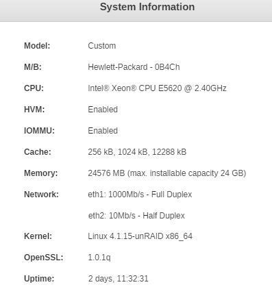

Do you have iommu enabled if you click info in the webgui?
Hi!
Yes, (Attached screenshot)
I have also attached PCI devices and IOMMU Groups.
