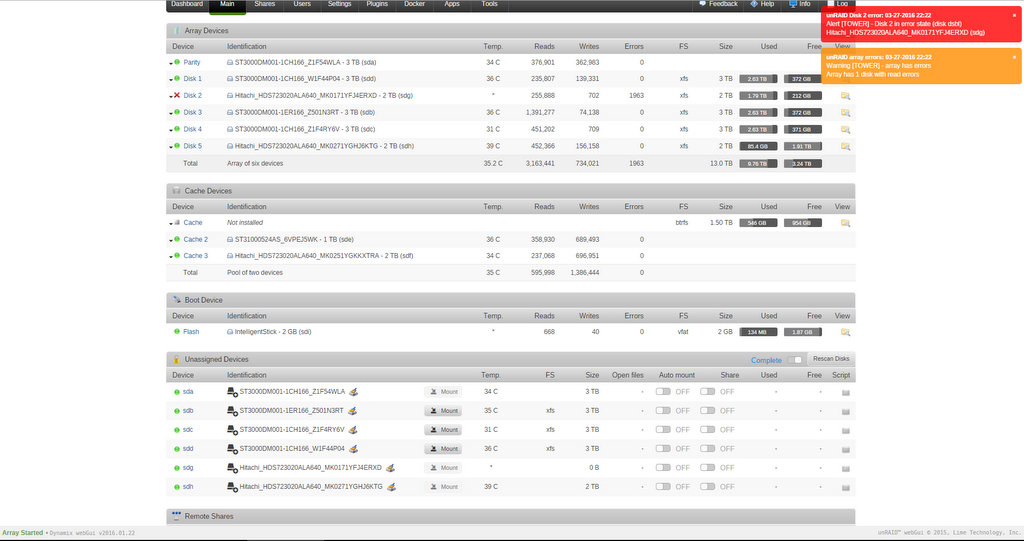

error, what's going on?
So is there an issue with this Hitachi disk?  Why are all the disks listed under Unassigned Devices?
I tried to go and look at SMART but it doesn't show anything.
I'm going to try shutdown and inspect cables since I just had the case open 24hrs ago.

Also, note that in the screen shot before the reboot all the drives are show in the Unassigned Devices section. Is this expected behavior for a failed drive/sata cable?

Any idea why in the OP screen shot before the reboot all the drives are show in the Unassigned Devices section?
I seem to remember this being mentioned before if the array ha not been started.  Was it started in this case?
