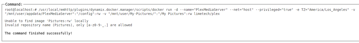

Hello, I just ran an update on limetech/plex:latest. My plex server disappeared. When I turned on the advance view button on the right hand side. I found plex server became an ophan image. I have tested some other folders that works fine before. Now I am getting all kinds of strange error messages. I am running on unRaid v 6.1.9 and Docker v 1.7.1. I have been running PlexMediaServer for over 2 years on unRAID. This is the first time unRAID just crashed and stopped working. From what I gathered, this could be a docker image configuration issue. Invalid repository name (Docker_app), only [a-z0-9-_.] are allowed. Please help. Thank you.

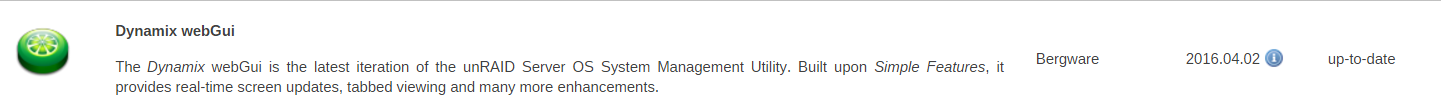

Plugins.  Check for updates. Install the webui update that's available
Thank you so much. I ran the Dynamic WeGui update and all my issues are fixed.
