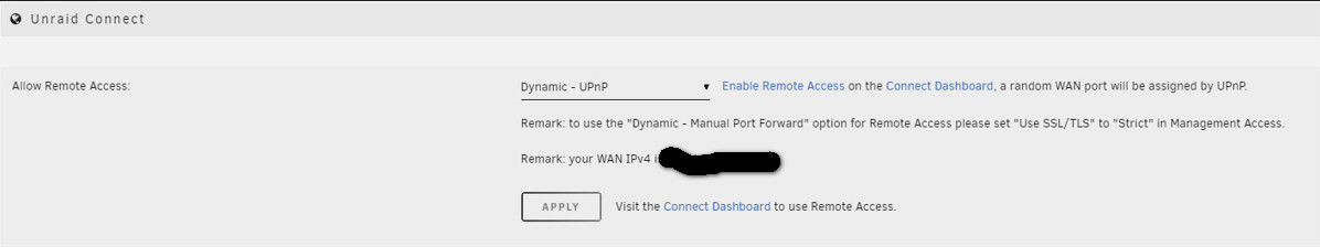

  1. I am trying to use dynamic option with uPnP. uPnP function is turned on from the firewall. All I am getting from unRaid-connect is "Enable Remote Access" with a spinning circle. It never established a connection. I wonder what else to look for?

  4. I just started testing the Allow Remote Access under Unraid Connect. The message is stating "Enable Remote Access" on the "Connect Dashboard". I think I am already in the Connect Dashboard. But, I don't see where I can enable Remote Access. Where is the button or selection? Is it already enabled?

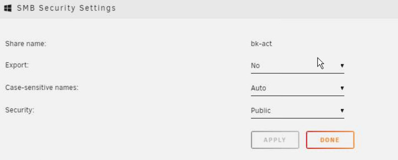

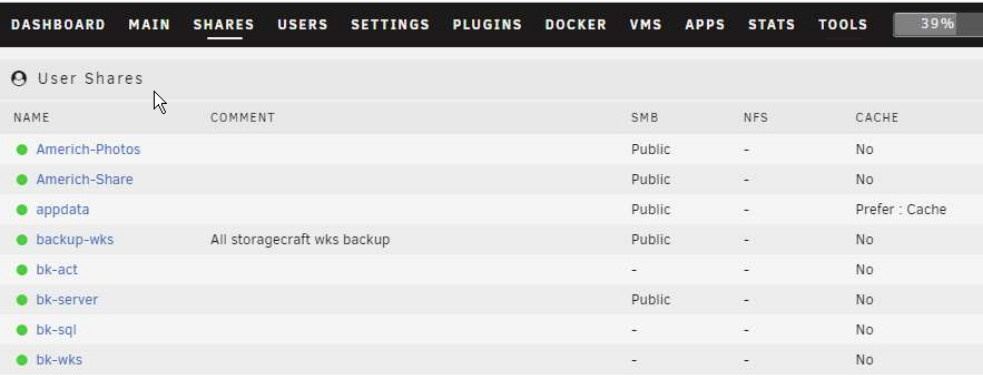

  7. I am having issues on multiple unraid servers accessing newly created file share under smb. Using windows explorer on Windows 10 or 11, it won't show the newly created folder. When creating these new shares, it is not shown as smb public. Am I missing some configuration steps? bk-act, bk-sql, bk-wks are the new folders. catower-diagnostics-20230202-1247.zip
