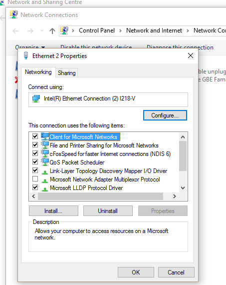

I may have found the fix.  It is a configuration option on the Workstation NIC:  Large Send Offload.
On my Intel 82579V GigE NIC, the option under Advanced Options of "Large Send Offload Version 2 (IPv4)" was set to enabled.  I changed it to disabled and rebooted.  Been good as gold since then.
Note to others: you might also want to disable "Large Send Offload Version 2 (IPv6)" too. Your PC will disconnect from the network momentarily after the setting change.
The option is under "Configure" button under adapter properties (see screenshot).
