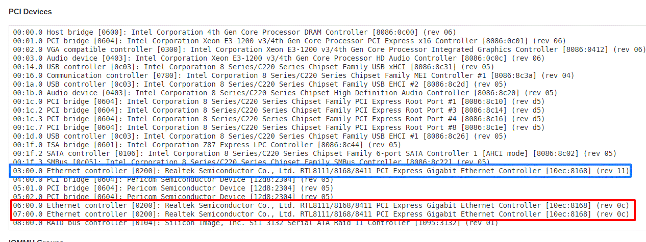

My PCI Devices are:
03:00.0 Ethernet controller [0200]: Realtek Semiconductor Co., Ltd. RTL8111/8168/8411 PCI Express Gigabit Ethernet Controller [10ec:8168] (rev 11)
04:00.0 PCI bridge [0604]: Pericom Semiconductor Device [12d8:2304] (rev 05)
05:01.0 PCI bridge [0604]: Pericom Semiconductor Device [12d8:2304] (rev 05)
05:02.0 PCI bridge [0604]: Pericom Semiconductor Device [12d8:2304] (rev 05)
06:00.0 Ethernet controller [0200]: Realtek Semiconductor Co., Ltd. RTL8111/8168/8411 PCI Express Gigabit Ethernet Controller [10ec:8168] (rev 0c)
07:00.0 Ethernet controller [0200]: Realtek Semiconductor Co., Ltd. RTL8111/8168/8411 PCI Express Gigabit Ethernet Controller [10ec:8168] (rev 0c)
08:00.0 RAID bus controller [0104]: Silicon Image, Inc. SiI 3132 Serial ATA Raid II Controller [1095:3132] (rev 01)
NIC 03:00.0 is my et0 and 06 & 07 are the dual port NIC I'll be assigning to pfSense.

The network card is being passed through to the VM correctly but something is definitely not working properly.
Whenever the guest OS tries to access the NIC the below error appears in the VM log file. Inside the VM the NIC goes up and down as if the cable had been removed.
processing error - resetting ehci HC
Later tonight I'll test with other NIC cards, I'm hoping it's simply a faulty NIC - fingers crossed.
