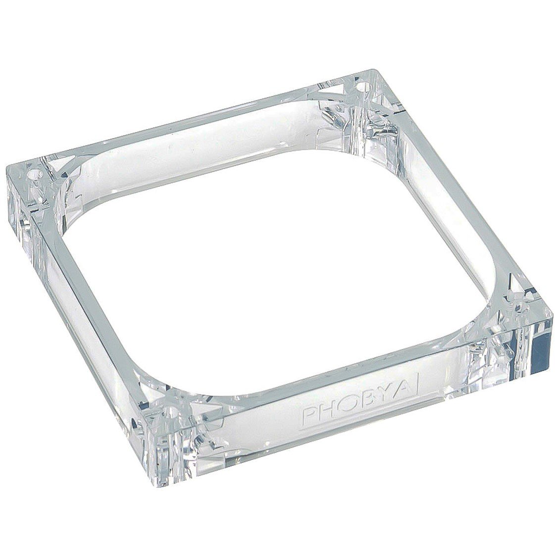

So I tried a AFB1212SHE-PWM because it is only 3700 max speed, and it is 38mm thick so it has better static pressure.  On the Supermicro with the fan speed at 30% duty, the fan spins at 600 RPM and is nearly silent.  Coupled with a 20mm fan shroud www.amazon.com/Phobya-38112-120mm-Plexiglass-Shroud/dp/B004CLFFIA (so the blades don't have to fly so close to the grill, another source of noise) I can barely hear the fan outside the case.  In fact, most of the noise is merely the air entering the grills on the front of the case and exiting the grill in the back (I am running with no exhaust fan other than the one on the PSU).
