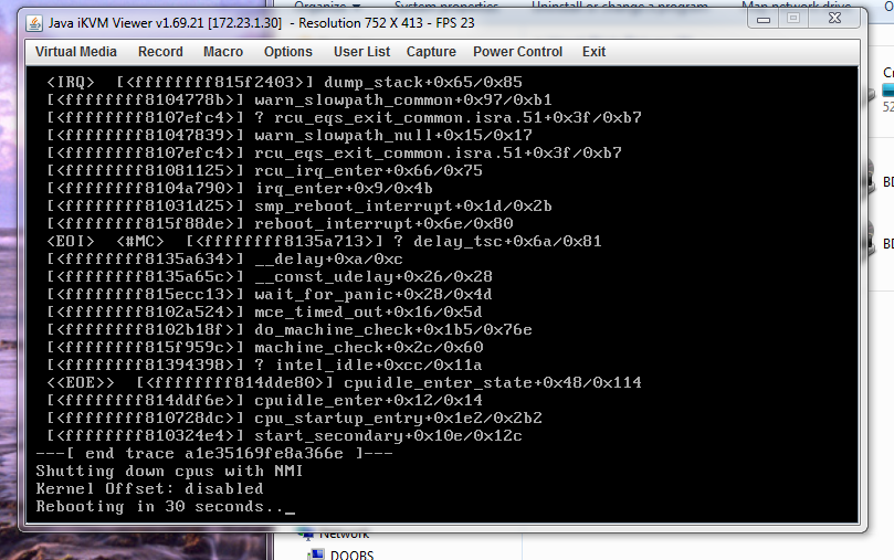

My system is crashing during a parity check and hoping someone can shed some additional light on the issue.  If I recall UNRAID runs in memory so the syslog doesn't appear to have anything useful.
I want to run a parity check before replacing the one drive showing a smart issue (reallocated sector count--been that way for a few months now).  I don't think that's the issue but wanted to check with people far more knowledgeable then myself.

Install Fix Common Problems plugin then put it into troubleshooting mode, then start a parity check.  If / when it crashes, post the latest diagnostics file AND the syslog.txt stored on the flashdrive in /logs

What is the exact model of your power supply?
Antec Earthwatts 650w. Ea-650
Been running for a few hours now and hasn't failed yet. Neglected to add that I suspected memory but ran memtest for 20+ hours with zero errors/faults.
Googling gives different answers on the number of 12V rails. 2, 3, even 4 +12V rails for the Antec ea650. How many does your power supply have?
And you have 22 drives. Sounds like a bad combination.
Well strange--it completed without any problems.
I wonder if it had to possibly due with overheating. All my sensors don't show overheating or any alarms but I had increased my fan speed to 70% (or whatever supermicro calls it) and it completed no problems.
Guess I'll continue to watch it.....
