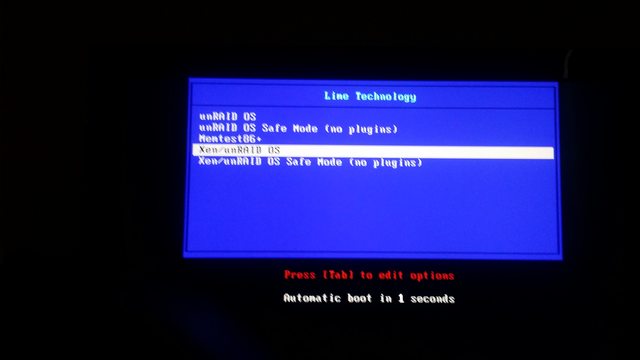

How can I boot in safe mode?
2nd option:
I dont have a screen attached to my server. is there another way?
on the wegGUI, click on the flash drive, Syslinux configuration will look similar to this:
default /syslinux/menu.c32
menu title Lime Technology, Inc.
prompt 0
timeout 50
label unRAID OS
  menu default
  kernel /bzimage
  append pci-stub.ids=8086:10d3 pcie_acs_override=downstream initrd=/bzroot
label unRAID OS GUI Mode
  kernel /bzimage
  append initrd=/bzroot,/bzroot-gui
label unRAID OS Safe Mode (no plugins, no GUI)
  kernel /bzimage
  append initrd=/bzroot unraidsafemode
label Memtest86+
  kernel /memtest
Move the highlighted "menu default" below the safe mode option.
